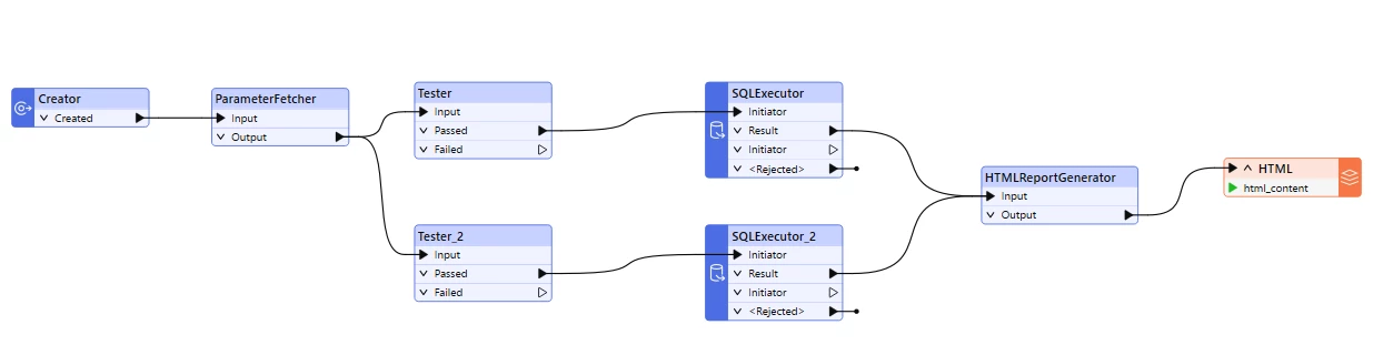

The screenshot below shows the simple flow - the users parameter values are tested to see which are blank/missing for when optional fields have no selections entered/chosen. The appropriate SQLExecutor then outputs the matches to the HTMLReportGenerator which creates a HTML table for the writer to generate the content.

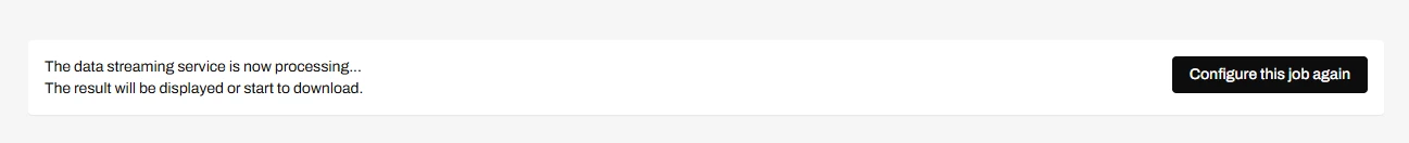

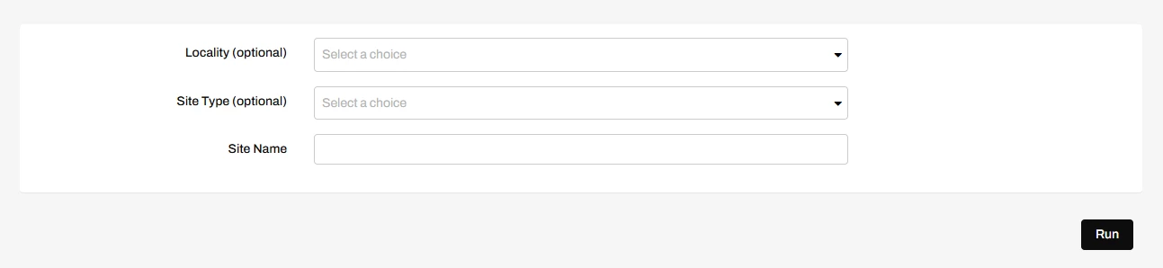

After the search parameters are entered, we get a data streaming service notice. The app goes from this:
To this after the user hits run (all within the App page):
It would excellent if once the job was finished and the table was ready to display, that the HTML content could be embedded in place of this message within the App page, so it keeps a seamless feel to the user.
