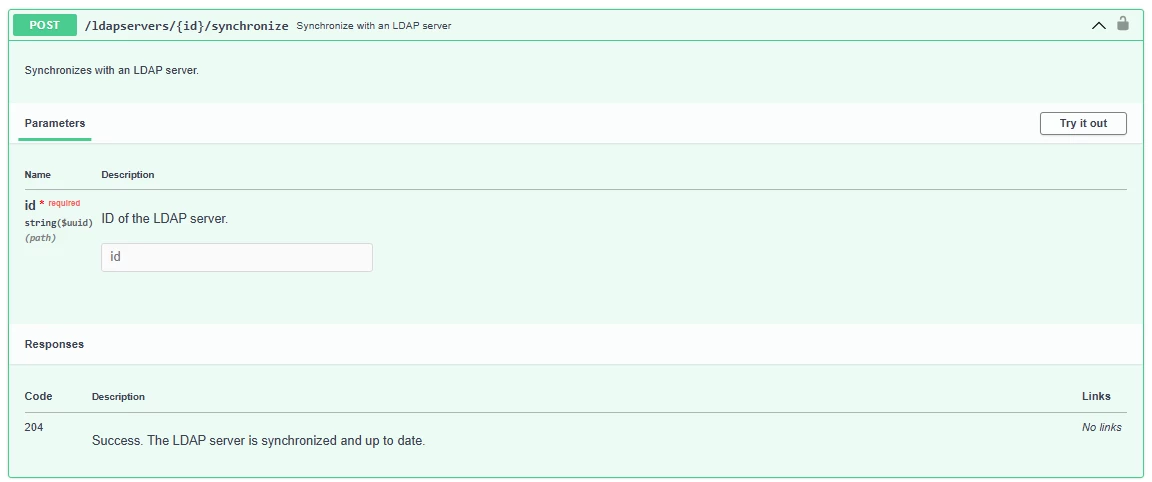

Yes — in this case a 204 No Content response is exactly what the FME Server REST API is supposed to return. According to FME’s Swagger definition, the /ldapservers/{id}/synchronize endpoint returns 204 when the synchronization request is accepted. The API call itself is working correctly.
I did enable the Rejected Feature Handling option as you suggested, and with that setting the workspace runs as expected. However, it still feels like FME shouldn’t treat a valid 204 response as an error in the first place. The same thing happens with the standard HTTPCaller, which also rejects the feature on a 204.
So everything is functioning on the server side, but the rejection behavior in the callers seems a bit like a bug or at least unexpected handling of 204 responses.
