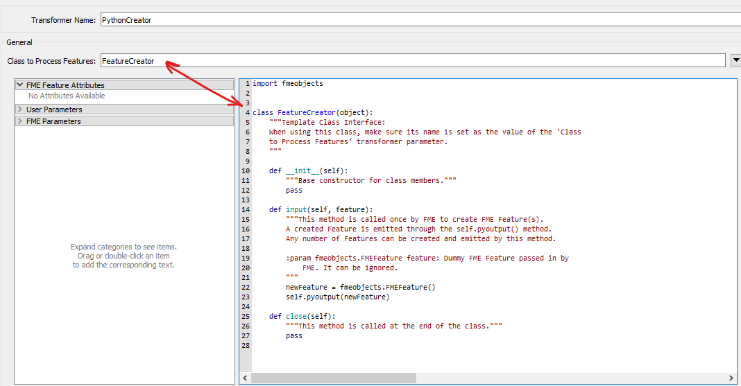

Any script in PythonCaller and PythonCreator must have a Class with a name equal to the “Class to Process Features” Parameter.  Otherwise there is no “Object” for FME to instantiate.
It is generally best to follow the template script and put your code into the blocks into the handler functions such as __init__ , input, or close that are called by FME on particular events such as a Feature entering the transformer etc.
