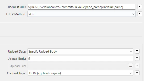

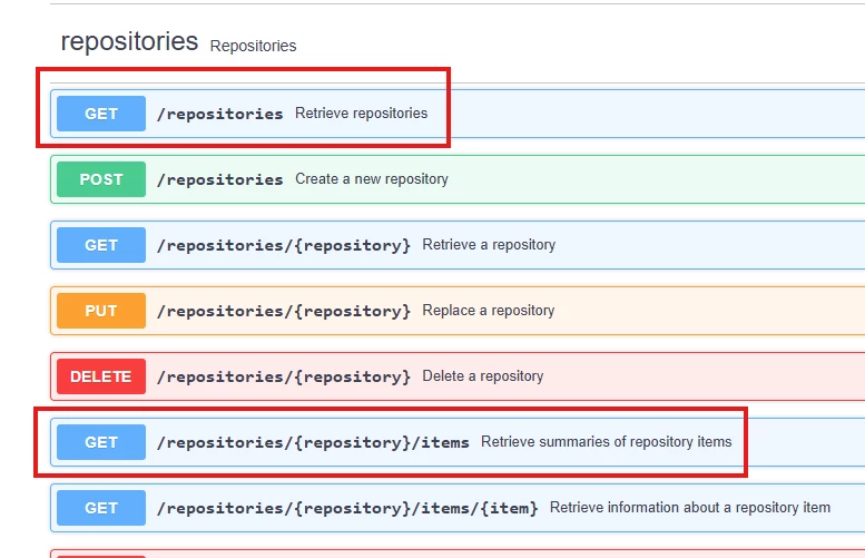

You can leverage the REST API to automate this,
  1. make a call to get all the repositories - /repositories
  2. make a call to get all the items in each repository - /repositories/{repository}/items
  3. Next we need to make a POST call to /versioncontrol/commits/{repository}/{item}. This API isn’t documented. You can inspect the network calls when clicking the commit button in the UI to see the full call It just requires an empty json upload body
  4. The local repository will now be up to date, and from here you can go and manually push to the remote repository.
Thats exactly what I needed! Thank you!
The commit button under workspace you mentioned is also useful, to do it manually!
