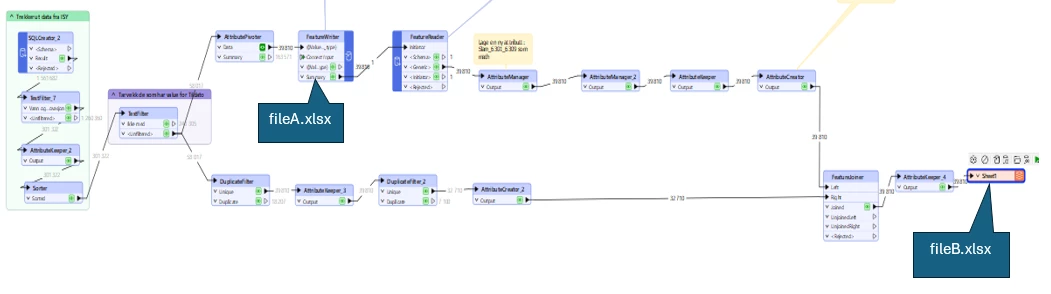

I wonder if using FeatureWriter and Feature Reader together in a workspace affects how the fmw runs in FmeFlow?
My fwm looks like that:
When I run the fmw in Fme Form everything works fine. I get the correct fileB.xlsx
Depending on the type of service used in FmeFlow, I get different results:
  • Data Download – error: 'E:\FMEFlow_Temp\fmeengines\localhost_Engine1\TempFS_1757066224587_10608\dsR_2_0\FME_22532F00_1757066082752_10608_0'. Error message was 'Permission denied
  • Job Submitter - The result file is correct and saved to the defined path in the Fme Form
  • Data Streaming - Under Uploads there are two folders: FeatureWriter with the fileA.xlsx and XLSXW_1 with the correct result fileB.xlsx
I have spoken with our IT department, and it seems that Fme Flow has full permissions to the temporary folder.
I would be grateful for any feedback
Ela

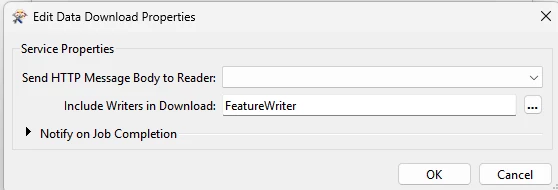

  • Sep 5, 2025 5:09 PM UTC
Did you include the Feature Writer in the writers to download parameter when publishing the workspace to FME Flow?
elzbieta
Forum|alt.badge.img+8
  • Sep 8, 2025 7:42 AM UTC
Hi JDH,
It works:) Thank you so much:)
