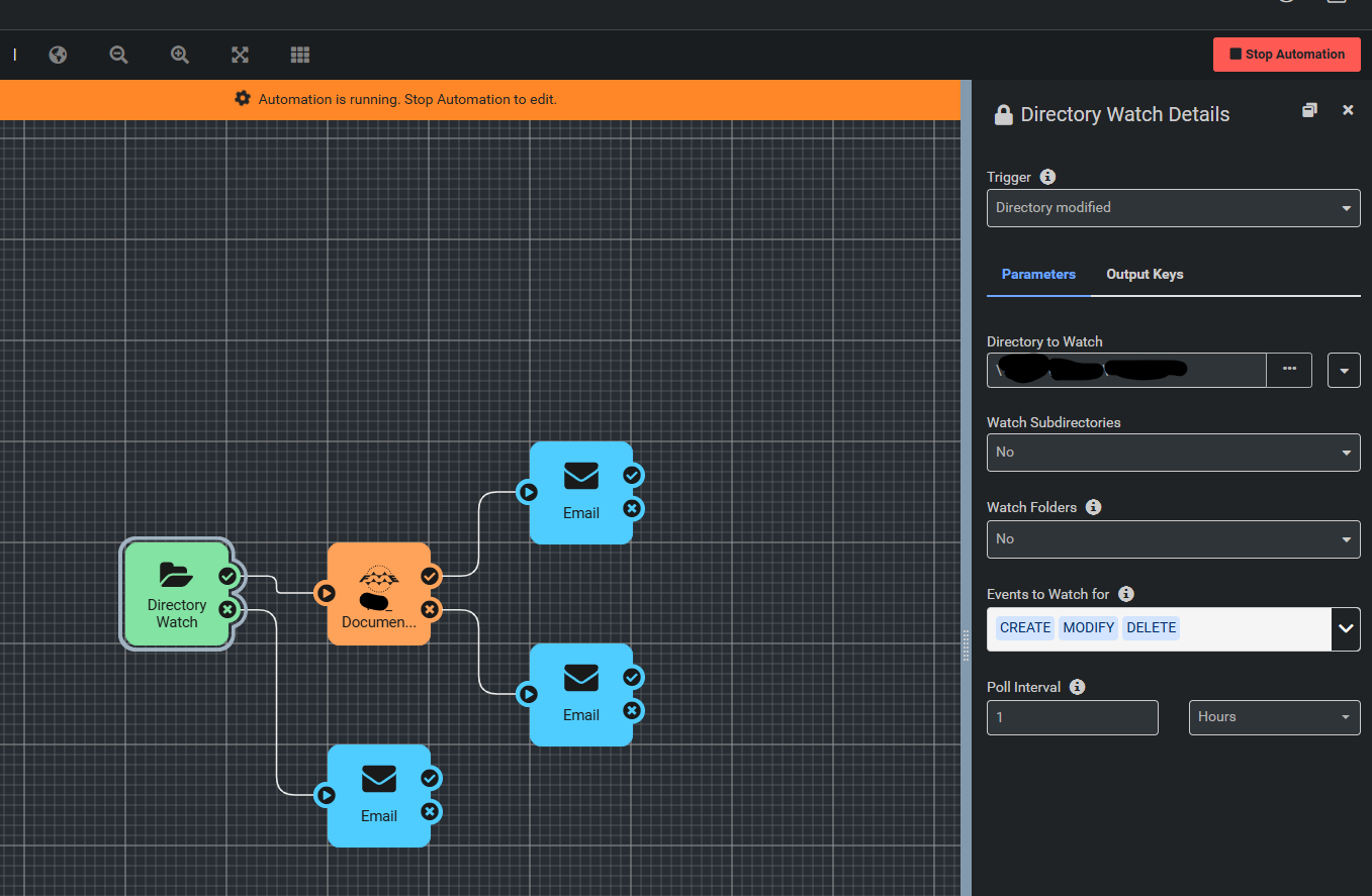

I am using FME Flow 2021.
I have an Automation that uses Directory Watch. When a file is added to the “Directory to Watch,” the Automation should run. But it does not run when a new file is added. I can run it manually, and it works as expected. In my screen capture below, it seems I need to add something to “Events to Watch for” to trigger. What am I missing?

  1. Where is the directory you are trying to watch? Is it local or somewhere on the network? (It is on our network and the FME Flow server can communicate with the server where the directory is located, the directory is also shared.) ---- do I need to add the folder the Directory Watch is watching to Files - Connections - Resources?
  2. Is this an express installation? And are the Core, Web, and engine services running under a service account or Local System? (This is an on-premises Fault Tolerant Installation, Engine1 and Engine2; all run under Local System)
  3. Could you expand on how you are running this process manually? (For manual, I use Manual Trigger in the Automation) What is your workflow that works? Is it working in just Form or Flow as well? (The workflow works in FME Form no issues, the issue is that when i use Directory Watch in the Automation and new files are placed into the folder the Directory Watch does not trigger)
Is there another “Event to watch for” I need to add? currently I have Create, Modify, Delete.
