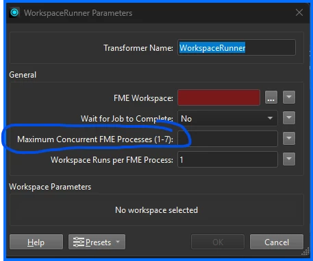

Hi ​@francisco_1988 Potentially yes. It is how you design the workspaces. You can have a workspace to read in shapefiles, process, then tester to call individual workspacerunners depending on results. Each workspacerunner can be set to process 1 at a time as well (below)
There are many ways of designing but the way you describe, read in shapefiles, perform a standard process, then do a custom process, I think this is an option to consider. Can you share a bit of your workspace? Might be able to get a better understanding. Hope that helps!
