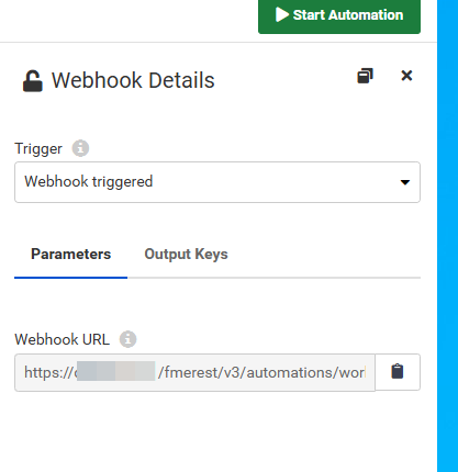

Using ArcGIS Enterprise 11.3 and FME Server, I am trying to create a Portal Organization Webhook. While I am able to ping the VM on Portal VM and also navigate to the webhook URL in Poral machine browser, I am getting this error
Unable to create or update webhook. Non reachable URL : 'https://xxxxxxxx/fmerest/v3/automations/workflows/4c2cbc0e-3df1-4cbe-9154-b866fe5b6a09/2274b9f3-c600-2ead-a2bc-a20dab4d8db0/message' has been specified for the webhook with name or id 'Check_Item_Name'
Can someone please let me know what I am missing here

Thanks for your comment j.botterill but I am getting this error at the very first step of setting webbook as you can see I am getting 404 error means can not reach the webhook URL which is https://xxxxxxxx/fmerest/v3/automations/workflows/4c2cbc0e-3df1-4cbe-9154-b866fe5b6a09/2274b9f3-c600-2ead-a2bc-a20dab4d8db0/message
Not sure why you are commenting on workspace stuff!

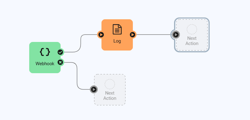

here is the Automation
