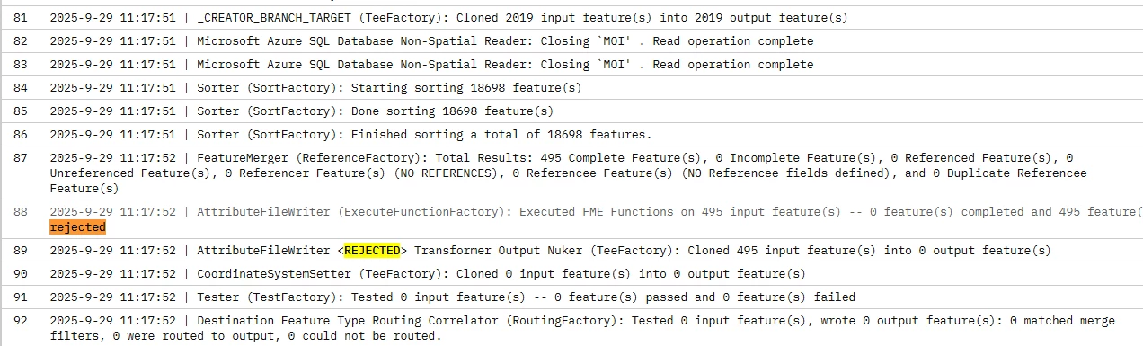

I have an FME Flow workspace app, and it won't run. It has worked for about a week, and after that it stopped working.
The problem is, according to the logs, the AttributeFileWriter. It just says, rejected, nothing more. We believe its the string we use to dynamically choose the output location of the photo's. See attached picture.

Best answer by jonathan_vru
It works again! I believe it's the problem with the forward or backwards slash. Nothing special :) Used the same string, but changed everything to a "/”

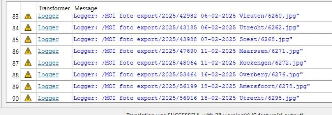

Thanks ​@ebygomm for your answer! No, they do not. I dont know if you consider this "-” a special character, that is the only one in use here. But that has worked before, so i did not place that on my list. I also used a logger to confirm the string, see picture below.

  • Nov 25, 2025 1:30 PM UTC
