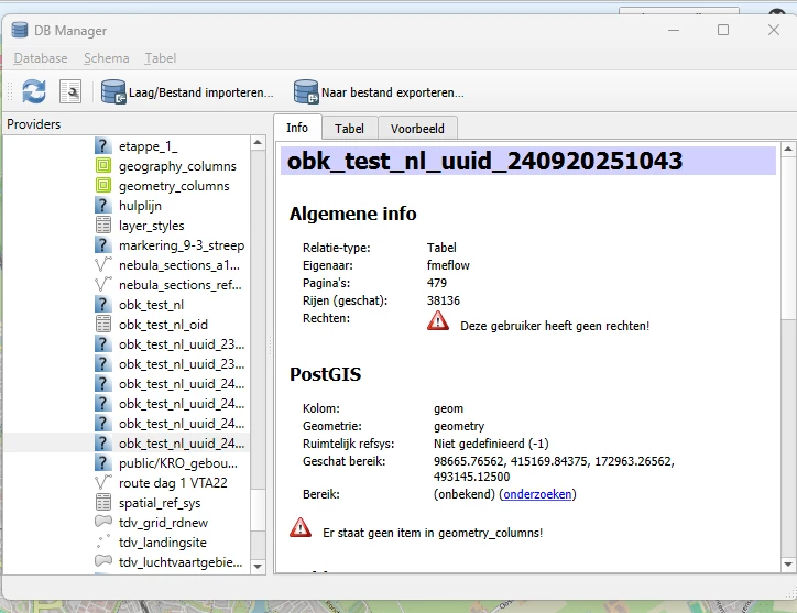

Goodmorning! I want to write a dataset with the postgis writer to GeoServer, but the result gives errors.
Process: A reader of municipal boundaries, and a reader with fire hydrants, the fire hydrants gets clipped on the boundaries layer, and then i want to write it to Geoserver.
The postGIS writer says its succesfull, but when i inspect the layer in QGIS, there is no data, and i get the error: there is no item in geometry_colums. What have i done wrong in the postGIS writer? Can anyone help me?

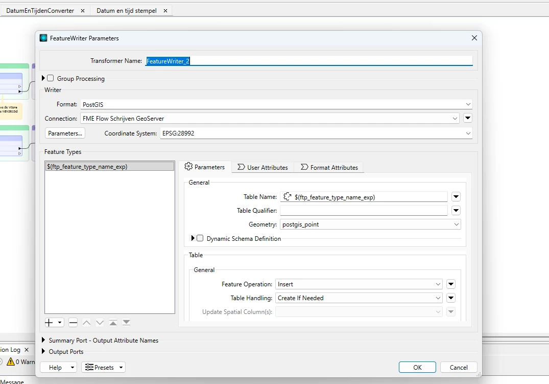

It will work by making use of the FeatureWriter, and setting Geometry to postgis_point

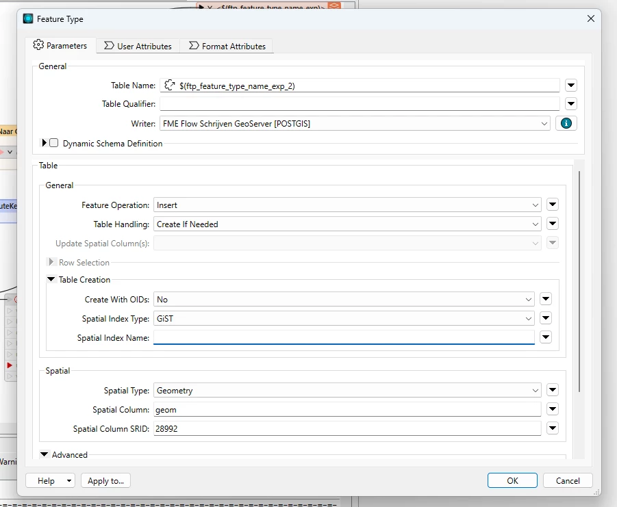

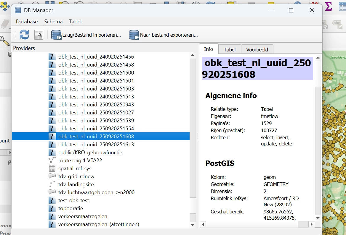

It finally shows the points, but the field "geometie"  has value GEOMETRY, where it should be point. How do i change that in my process?
