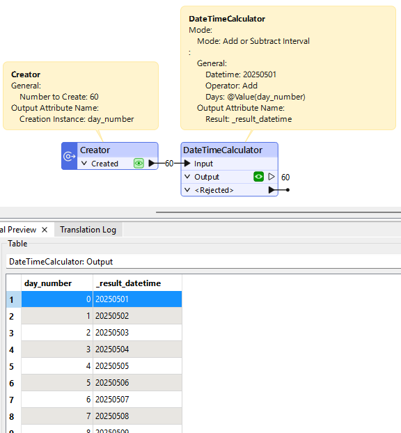

Clone the initial feature 60 times and then create the date parameter using by adding the clone number of days to the starting date. Then send all these into your http callers, you probably want to consider a decelerator to limit the rate of requests

  • May 14, 2025 2:29 PM UTC
Example for creating 60 features with increasing timestamps, starting on 2025-05-01:
