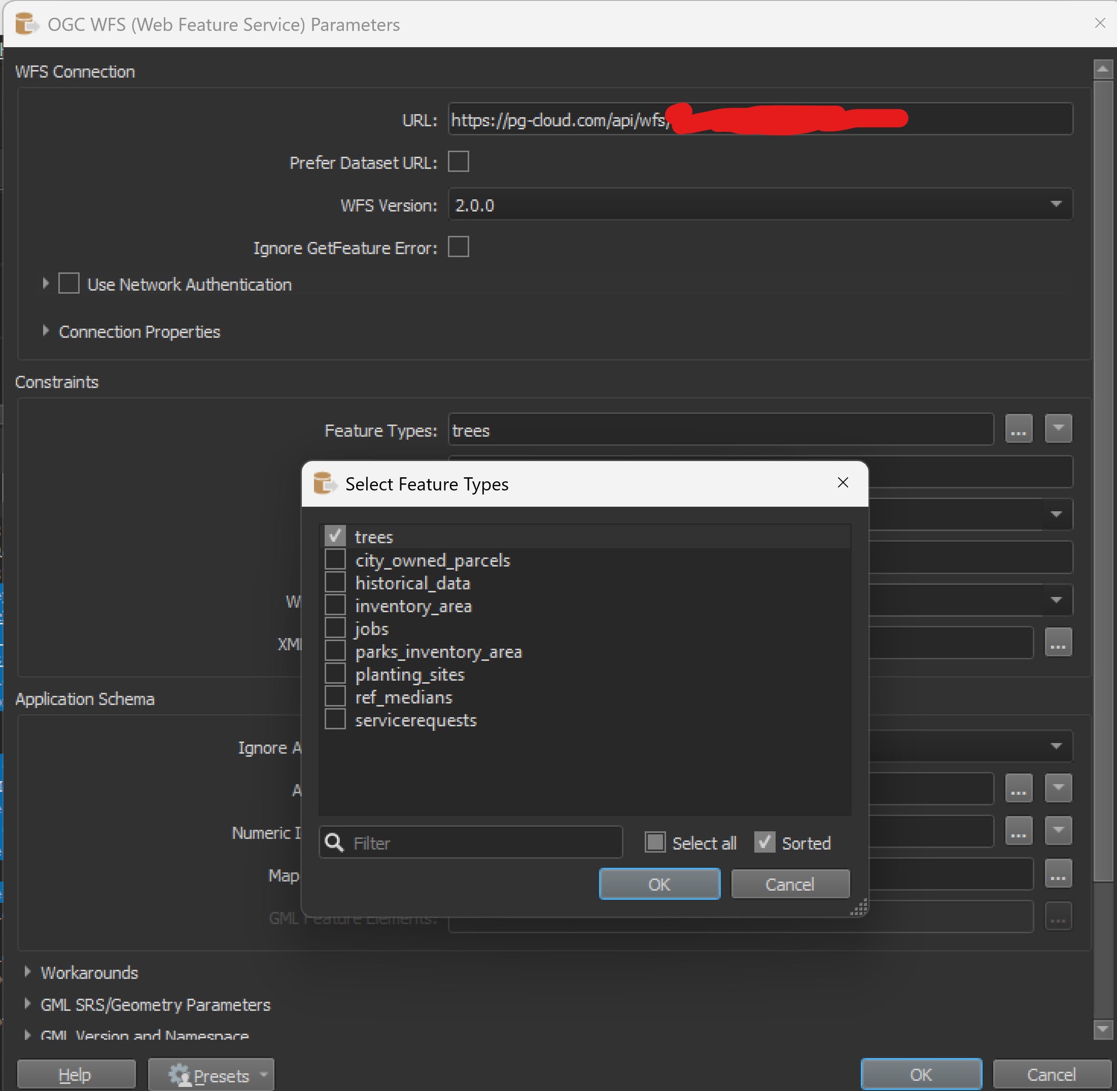

I am using the OGC WFS Reader to try and connect to my site in the TreePlotter App (cloud based app by PlanIT Geo). I have the API Key and other parameters.
When I run the Reader, I get these errors (from log file). Does anyone have an idea on what could be causing this? (I followed the instructions from their website: https://support.treeplotter.com/knowledge-base/wfs/

In the WFS Reader it appears I can connect to the site, I can see the layers:

If I see stuff like this my first thought would be that there is actually a problem on their side. Are you using a spatial filter? And can you maybe try to perform the getFeature call manually in the browser to check if it atually works outside of FME?
