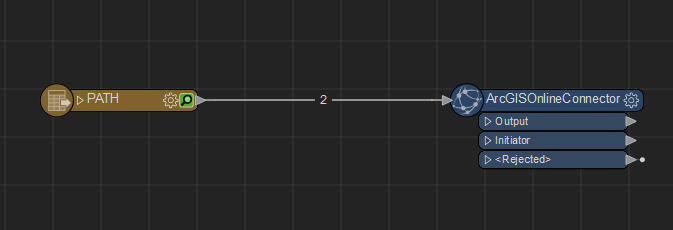

I have a zipped File GDB that I have uploaded to AGOL using the ArcGISOnlineConnector.

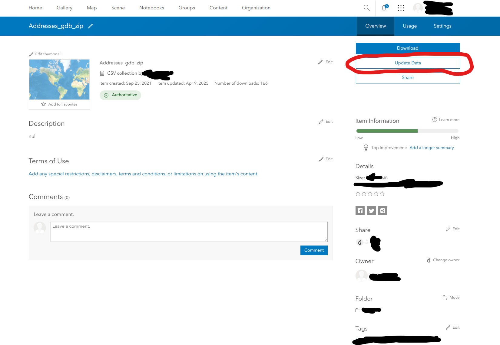

The next step is for me to update the data. See 2nd screencapture in red circle, “Update Data”. Is it possible to update data in AGOL using FME? if yes, what transformer do I need to use?
