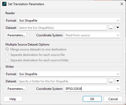

Best answer by raghavendrans
​@raghavendrans  What is the name of that transformer?
It is not any transformer.
It if FME Quick Translator, which can be invoked from Start menu, under "All Programs > FME Form [Version] > FME Quick Translator," or by browsing to a file, right-clicking, and selecting "Translate with FME Quick Translator".
Once you have the FME Quick Translator, go to File > Translate and you will see the dialog box as in my post with the Readers and Writers, which are to be set to Esri Shape File in your case.
Hope that helps.

raghavendrans
Forum|alt.badge.img+28
​@simeon.simic
EPSG 32634 is UTM Zine 34N WGS84
From your email, I understand that you want to convert the SHP file in Gauss Kruger to EPSG 32634.
If yes, you just need to create a SHP to SHP translation in FME Quick Translator and set the Destination Coordinate System for the SHP file write to EPSG 32634.
Let me know if this is what you need.
Happy FME :-) -ing
Cheers
SRG

raghavendrans
  • May 12, 2025 9:14 AM UTC
Hope that helps.
Happy FME :-) -ing
Cheers
SRG

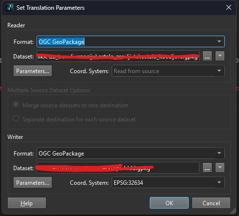

simeon.simic
Forum|alt.badge.img+6
  • May 12, 2025 9:27 AM UTC
​@raghavendrans
I do get error’s from this screenshot above
And yes, i am trying with geopackage, i assume that the process is the same as for .shp
And my configuration is :

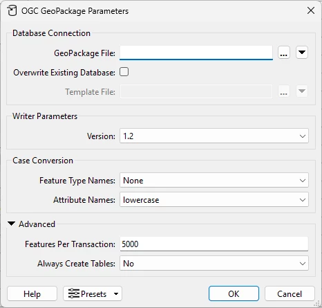

raghavendrans
​@simeon.simic
That is correct, the process is the same as SHP to SHP.
From the error screenshot, it looks like there is an issue while writing the output Geopackage.
For the Writer part, can you click the “Parameters” button to check if the settings are as below, but for the path of the output Geopackage file?
If you are trying to overwrite an existing file, I would suggest to try writing to a new file instead.
SRG
simeon.simic
  • May 12, 2025 9:49 AM UTC
​@raghavendrans
Yes, the configuration is exactly the same as yours
I think that errors are because i dont have a schema, i just have one column with fid from QGis, maybe that’s the problem
