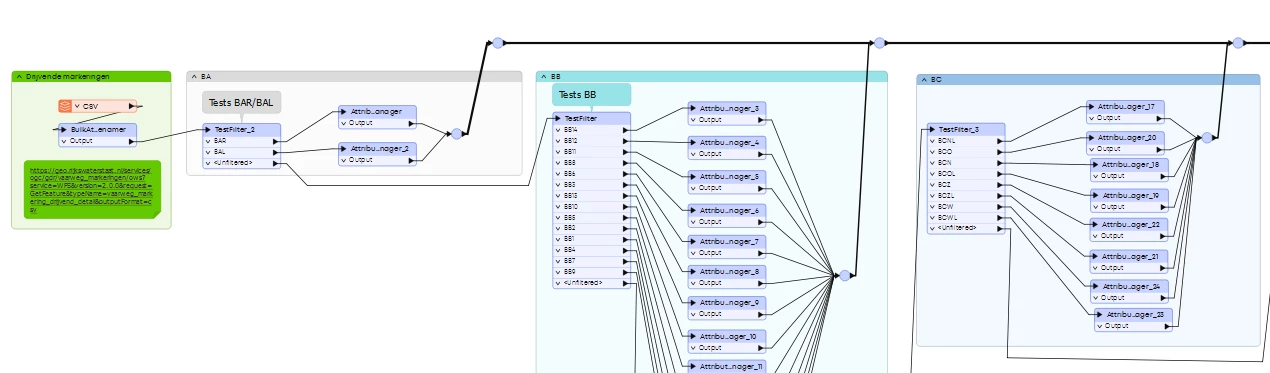

One of my (not) favorite is seeing a testfilter used then passed to an attribute creator when either conditional values or another transformer could be used.
The one that sticks in my mind was when the output data needed to be assigned a group, each group could be a max of 10 features.
It went counter → testfilter → attributecreator(s)
There were over 100 clauses in the testfilter each being output to an attributecreator that assigned it to group 1, group 2, so on.
I’d hate to think how long it would’ve taken to configure each of the test clauses and subsequent attribute creator.
Much like ​@david_r s example, it was all nicely stored in a bookmark, so you had no idea until you expanded it!!

I actually have a workspace like that! Based on a number of criteria I need to set 5-6 attributes, but there's a lot of options. There's 101 AttributeManagers in this workspace 😁
Because it's several attributes that need to be set rather than one, I decided against using Conditional Values (well, actually, they're still being used a bit!). Having one AttributeManager with 100+ rules in a Conditional Value isn't exactly a Best Practice either.
I could have used a SchemaMapper, I think, but that would be a massive mapping table. So all things considered I still think this is the “best” solution for a complex problem (and this is also a workspace we often show at training courses).
What it does is quite cool too, it processes data for navigational aids along inland waterways (bouys, lights and so on). Used to be a manual process in Excel that took one person 2-3 weeks (he was the only one who knew how to do it) per run and generally there were 2-3 runs per year necessary. It now takes the data from an online service and runs on Flow, whenever the cartographers need it, in about 2 minutes 😎

In that case this looks good in my books!
The one I came across could’ve been (was) replaced with an arithmetic expression similar to
@ceil(@Value(_count)/10)

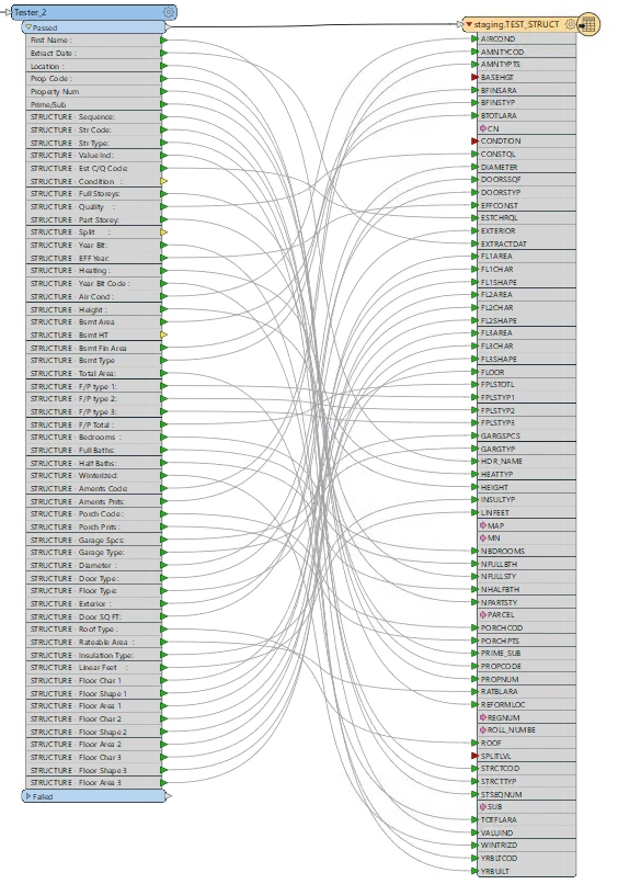

I’m currently redesigning a process for a client and I found this while trying to do the mapping
(Also some attributes a lot of attributes are removed directly in the Reader)
redgeographics
VIP
Forum|alt.badge.img+63
This would be a very good case for the SchemaMapper though! Or… replacing all that mapping with an AttributeManager
As for the removing attributes on the Reader, we generally advise against it and recommend to use an AttributeKeeper or -Remover instead, with the reason being that that makes it immediately obvious that attributes are being removed for anybody else looking at the workspace.

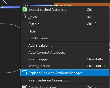

I once found out a colleague had painstakingly put all the mappings into an AttributeManager instead of doing this
I actually often drag the connections and then use the Replace Link option to set up the Attribute Managers as I find it far easier.
Wish you could do the same with a FeatureWriter.
