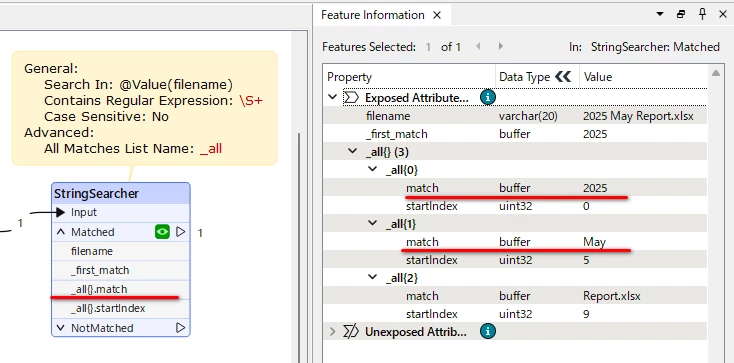

Hi ​@aashnaparikh ,
I agree that using AttributeSplitter would be easier in this case, but of course StringSearcher can also be used to extract year and month from filename. Take a look into how you can use the All Matches List Name parameter or the Subexpression Matches List Name parameter in the transformer.
The screenshot below illustrates an example of All Matches List Name parameter use.
