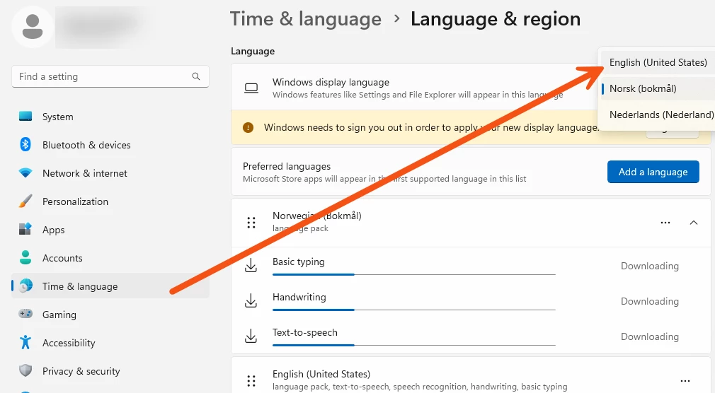

I believe this issue has been fixed for 2024.1 which should be released soon.
For now, if you set the display language to English this seems to work as a temporary workaround.
Please let me know if this works for you.

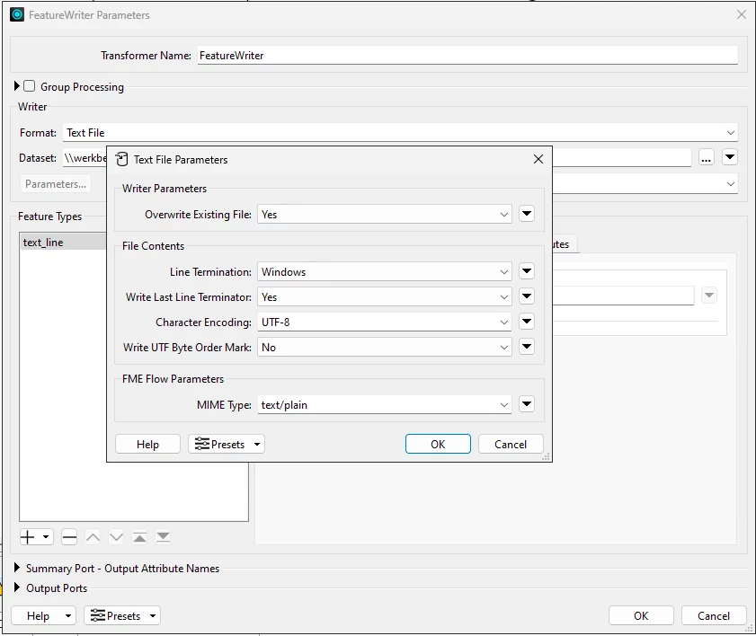

Specifically in a FeatureWriter that writes a Text-file in UTF-8 to a network drive. Happens both in Form and Flow, although the encoding mentioned is slightly different (local machine versus server):
Form:
2025-12-12 10:22:02|   0.6|  0.0|INFORM|Creating writer for format:
2025-12-12 10:22:02|   0.6|  0.0|INFORM|Using MultiWriter with keyword `FeatureWriter' to output data (ID_ATTRIBUTE is `multi_writer_id')
2025-12-12 10:22:02|   0.6|  0.0|INFORM|Creating writer for format: Text File
2025-12-12 10:22:02|   0.6|  0.0|INFORM|Trying to find a DYNAMIC plugin for writer named `TEXTLINE'
2025-12-12 10:22:02|   0.6|  0.0|WARN  |The current FME process locale has been changed from 'Dutch_Netherlands.utf8' to 'Dutch_Netherlands.1252' and FME has restored it back to 'Dutch_Netherlands.utf8'. It is undefined behavior to call 'setlocale()' in plugin code and doing so may cause unexpected errors
This happens in the following FeatureWriter:
Nothing special, just a simple text file with a single line of text in it (it’s a check to make sure FME can actually write to that network disk location).

Regarding the workaround, I believe Crystal may be referring to Windows System Settings (not a setting in FME). You can find this here: Settings > Time & Language > Language & Region
Please let me know if changing that clears the message for you!

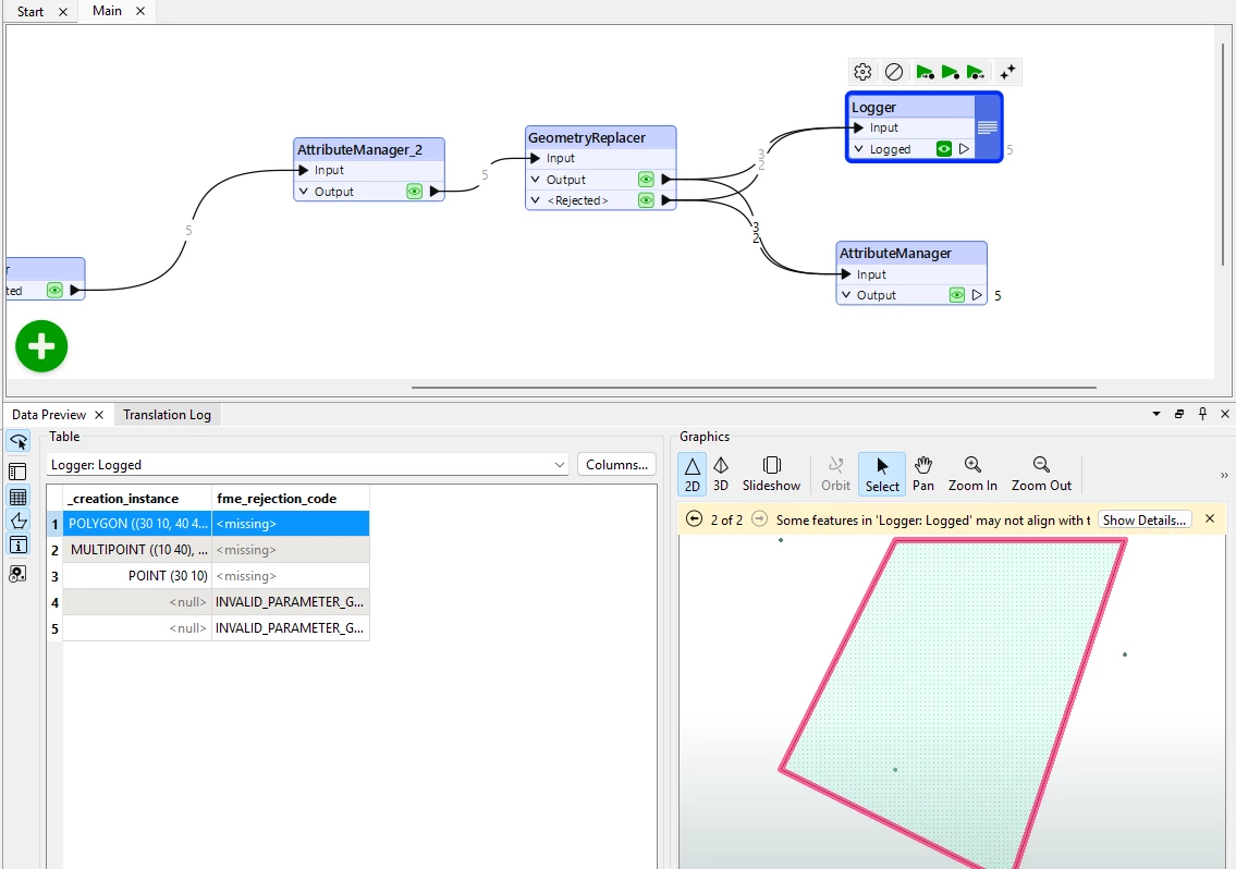

It is a warning, it did not stop the translation. Since I did not do anything with the rejected port, it did cause a good 3000 - 4000 features to disappear and not be processed however, which became obvious when certain features were expected in the output but did not show up - so initially it did mess up Production. It took me quite some time to figure out where they disappeared, which turned out to be the Rejected port of the GeometryReplacer. Using the workaround with the WKB attribute solved it though.
I still find it a bit strange that (I haven’t investigated this, it’s a hunch) it always seem to be the same features, with nothing to distinguish themselves from other features. I should probably log them and their Guid’s to check that.
Ah, that’s why I couldn’t find it 😄. That is not going to help me locally though, since we are running FME as a remote Azure app. And the same thing happens on FME Flow, which runs on a server - where I’m fairly certain the region is already set to English US. You can see from the Flow warning:

Generally, warnings shouldn't stop translation - this is definitely not expected behavior! We'd want to dig into this more to ensure workspaces are running as expected.
​@s.jager I was able to reproduce the warning message! Thank you for sharing that info. It does appear that the translation runs well in my testing. I was able to write data as expected. I am curious about those missing features you mentioned!
It sounds like you did some good digging and already found issues with the GeometryReplacer. Errors with this could be that there's some values in your dataset that aren't OGC WKT compliant. I'm also curious if you maybe ran into something that I've seen before, where NULL values are rejected when the Geometry Encoding is OGC Well Known Text.
To investigate I'd recommend using the Logger! Also, in case you didn't know, if it does happen that the values are NULL and you still want to keep them in your dataset, you can connect both rejected and output port to the rest of your workspace and it should keep all those values!
Let us know what you find with the Logger! 🙂
None of that is the case. All WKT is generated by SQL Server’s .STAsText() function, which is executed as part of a larger select statement by an SQLCreator, and a check is done on whether that value is NULL or EMPTY (sometimes EMPTY polygons are generated - then the word EMPTY is in the WKT, so simply checking for NULL is not enough) before feeding it to the GeometryReplacer. All polygons are valid geometry as well, both tested in SQL Server and FME.
