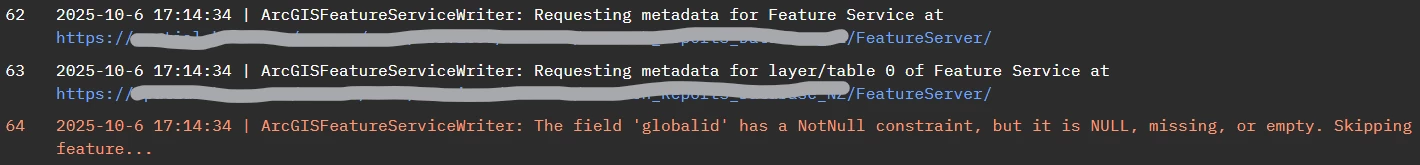

I tried to write some data to a ArcGIS Portal feature service using the new writer.  It skipped my feature as globalid was NULL, missing or empty:

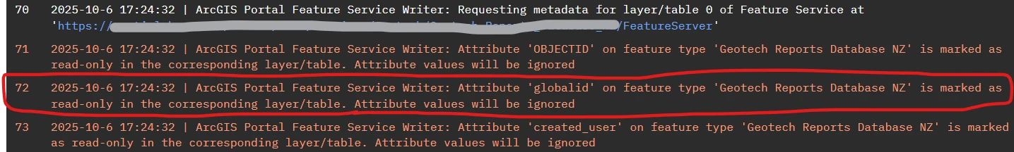

So i fell back to the old writer and this writes features fine. It sees that globalids are read-only and ignores them, along with the other ArcGIS server managed fields:
I imported the same layer from the feature service using the writer - import layer approach, and fed the same data into both of them in the same workspace.  One works, one doesn’t.
Am I missing something?

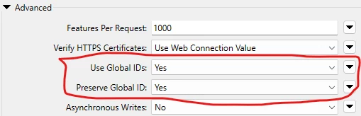

Thanks to ​@rjlockie for reminding me about the globlid related settings in the advanced writer parameters. changing these to yes fixed the issue:

I have the same issue. When turning these advanced globalID settings on, fme gives the following error:
|ERROR |ArcGISFeatureServiceWriter: Writer configured to use Global IDs, but this is not supported by the Feature Service
I have checked the feature layer and Supports ApplyEdits With Global Ids is set to true. What am I missing??
