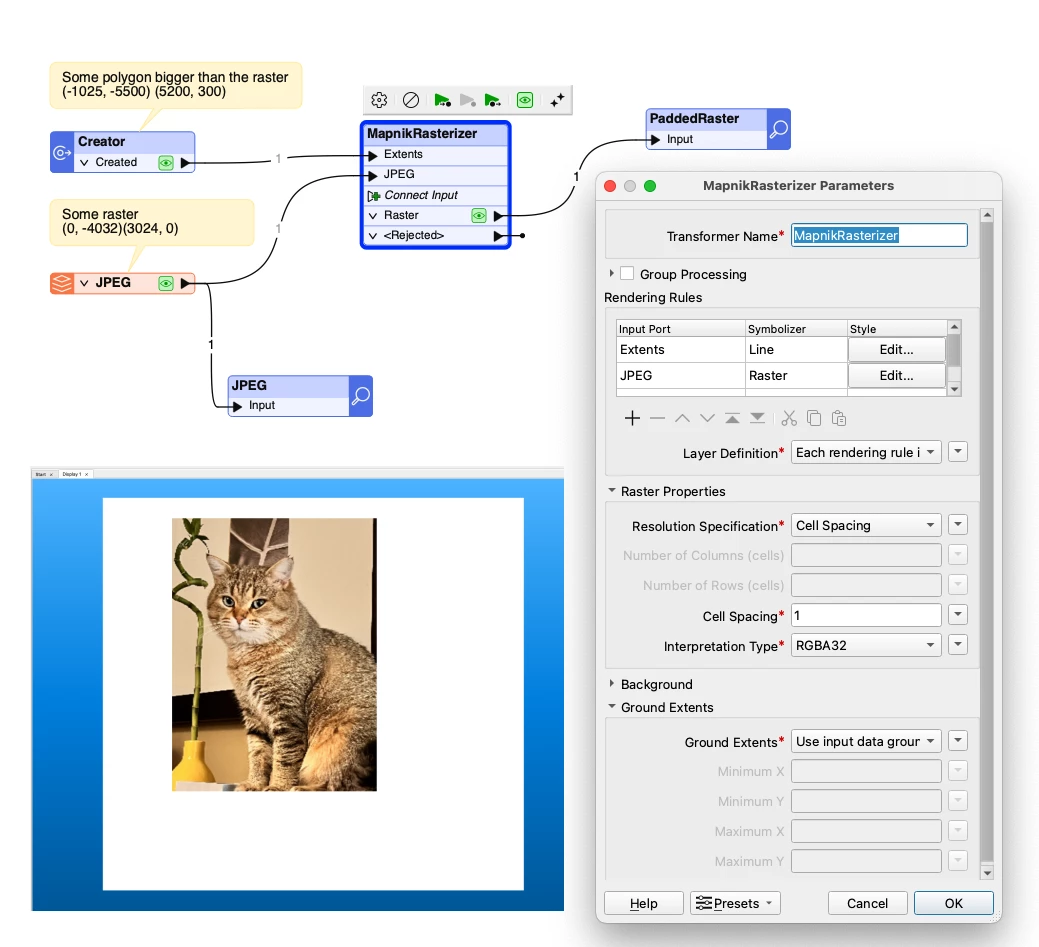

Your second idea is not bad at all, but yes, it will require a few transformers - extracting raster properties, merging the polygon with the raster to pass raster properties, rasterization, and mosaicking, plus taking care of nodata or carefully tracking feature order. Maybe wrap it into a custom transformer, and in this case if will look efficient 😃.
I probably would go with MapnikRasterizer. Send your polygon to it, style it as a Line with opacity = 0, and then send your raster, set its Symbolizer to “Raster” with no other settings. Set spacing to the spacing of the original raster, and make sure to set input data ground extents.
Here is the screenshot of the workspace and the output. Keep in mind, MapnikRasterizer supports only RGB24 and RGB32 interpretations, so if you deal with different interpretations, you can either coerce rasters to these two interpretations, or you give your Mosaicker idea a try.

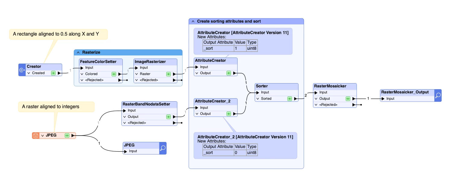

You can let your raster define the pixel boundaries - it needs to enter the Mosaicker first. Just set polygon color to black (0,0,0), and set nodata to 0 (so it will be transparent), add two AttributeCreators with a sort attribute, set it to 0 on the raster, and to 1 on polygon, and then in Sorter sort them ascendingly.
In the attached workspace, my polygon corners are rounded to 0.5, and the raster is snapped to integers. Depending on sorting, either the raster or the polygon “win” the cell extents.
