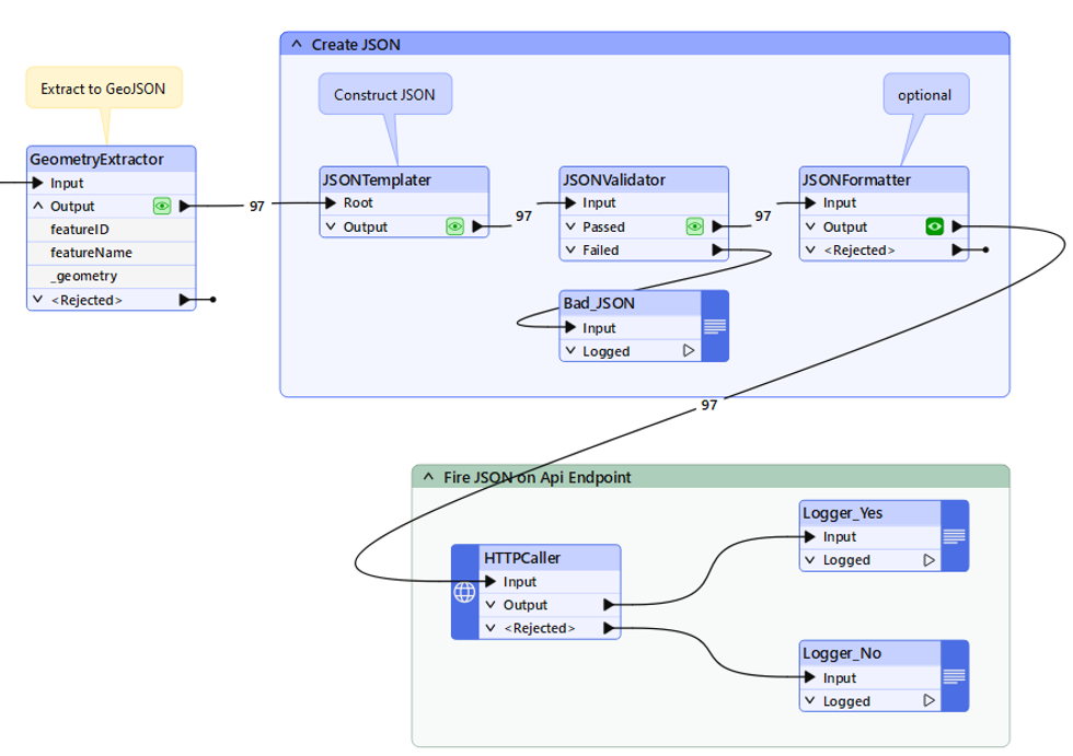

hello! I am currently working on an API integration project. My task involves reading data stored in an ArcSDE geodatabase, selecting specific data, and posting it to a website. The website accepts data in JSON format, which should follow a specific structure:
  "type": "Feature",
  "properties": {
    "id": <id>,
    "name": <name>
  "geometry": {
    "type": "<geometry_type>",
    "coordinates": <coordinates>
I read data from ArcSDE geodatabase and the option that converts data into the format above is GeoJSON writer. however, this writer saves the GeoJSON file to a directory, which I do not want. Instead, I need to convert the data into the required JSON format using a transformer, Extract specific parts like geometry and property from the JSON format that can connect with an HTTP caller to POST the data. I'm not sure which transformer would be suitable for generating the desired output. I would greatly appreciate any advice or help! Thanks!
Best answer by frro
Hi
I would do it like:
  1. GeometryExtractor - pull the geometry to GeoJSON
  2. JSON Templater - construct the complete JSON
  3. HTTPCaller - fire the JSON on the Api-Endpoint
Adding some screens
Workspace
Construct desired JSON from attributes
Shoot JSON on Api
Hope that helps :)

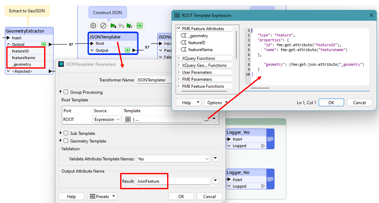

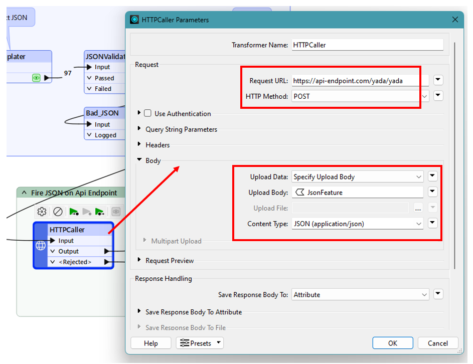

Hi
I would do it like:
Adding some screens
Workspace
Shoot JSON on Api
Hope that helps :)
fme_can_do_it
Forum|alt.badge.img+13
  • Feb 12, 2025 6:41 PM UTC
​@frro  Thanks! I applied the same approach to construct the JSON. However, when I routed the formatted JSON to the body, I encountered a 500 Internal Server Error. I also changed the workspace and attempted to upload the body through the text editor, but it still didn’t work. It’s strange because the data works perfectly in another application and successfully generates a response.
