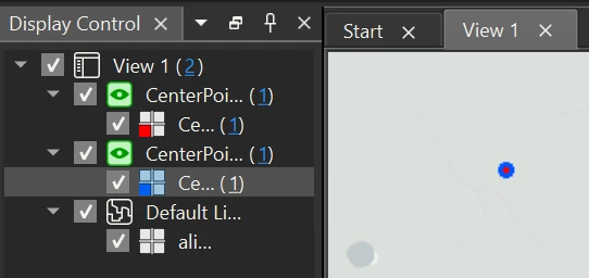

What you want to achieve is how I read that the CenterPointReplacer set to “Any inside point” should work:
However, it seems like this is not just a point randomly generated on the fly, because I get the exact same point every time I try it with the same input geometry:
Yes, I did remember to set them both to “Any inside point” 😅
My attempt at showing two points at the exact same location
 This would suggest it is not litterally arbitrary, but rather that each specific geometry sets a specific “seed” that produces the exact same result every time … 🤔

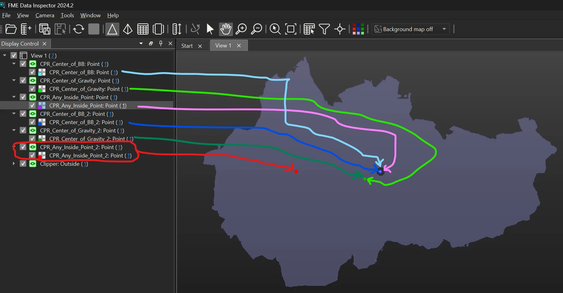

However, I had a go with this. I first took a polygon and did three separate CenterPointReplacers (CPRs for short ...). In this case, it turns out the cyan Center of Bounding Box (CoBB) and the magenta Any Inside Point (AIP) is identical, i.e. AIP tries to first use CoBB for point placement. The light green Center of Gravity (CoG) is slightly to the southwest of them both.
I then cut of a circle with 1 km diameter around the CoBB point and tried the three CPR algorithms again. The CoBB is identical, the CoG correctly differs only a few meters since the polygon is now a donut with a slightly skew center of gravity, HOWEVER, the AIP is nowhere near either of the other two algorithms, but is instead located way further west:
If I add another CPR with AIP on the same donut polygon this will also be placed at the exact same location. My conclusion is then, that CPR will first try CoBB, and if this fails it will not use CoG but instead generate a point at a specific “random” coordinate, except that the rng seed will be determined by the polygons geometry and thus be exactly the same every time you use the same polygon.
It would be nice to have “random toggle” in there, like you do in the Sampler for instance, as that would solve Mark’s “problem”. :)
