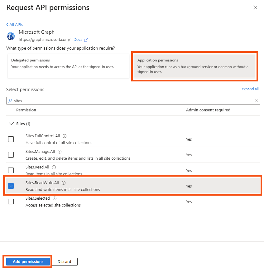

In the second URL, it suggests to have
but I only have Sites.Selected or Sites.ReadAll option from the ADMIN.

I think your Azure administrator needs to grant approval for all application level permissions.
But back to your requirements. On the first article you will find section “Determine your Requirements” and specifically #3 Do you want to connect on behalf of a user or as an application
The SharePointOnlineConnector supports access on behalf of a user, where Microsoft Graph API delegated permissions have been granted to the Azure app registration.
As of FME 2024.1, it also supports access as an application, where Microsoft Graph API application permissions have been granted to the Azure app registration. BUT MAYBE YOU DON’T NEED THIS, perhaps you could use the Delegated scope?

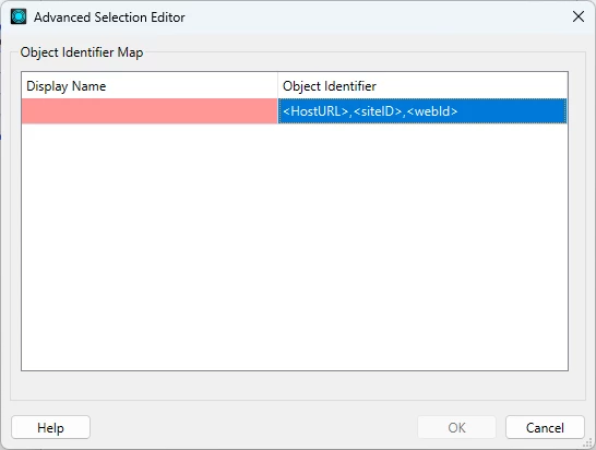

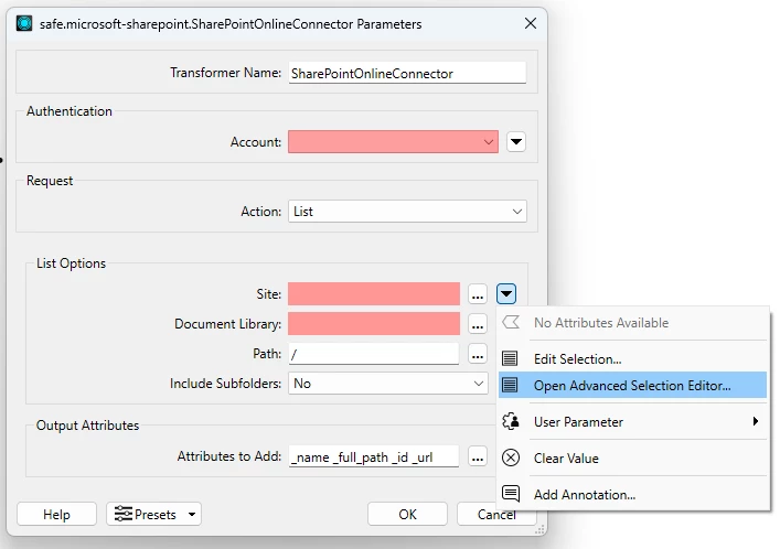

If you are planning on using the SharepointOnlineConnector transformer with Sites.Selected there is a workaround.
Open the Advanced Selection Editor for the Site parameter. For the Object Identifier, hard-code <HostURL>,<siteID>,<webId> with your values. Remove the angled brackets and ensure the values are separated by a single comma with no spaces. You can save these values in a separate document and copy them over each time or save the parameters as a Parameter Preset within FME.
There is a note about Sites.Selected in our documentation: API Permissions: Sites.Selected
