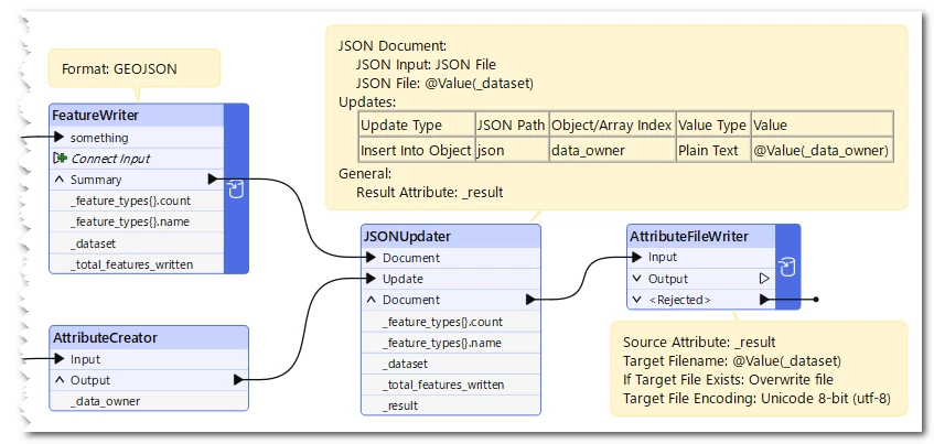

A possible way I can think of is, after writing a starndard GeoJSON document with FeatureWriter, update the document with JSONUpdater transformer and then overwite the updated document to the same file with AttributeFileWriter or Text File writer, etc.
This screenshot illustrates a workflow example.
Just be aware that you cannot control the order of objects with JSONUpdater. If you want to insert “data_owner” object into a specific position in the document - e.g. before “features” object, you will have to consider another solution.

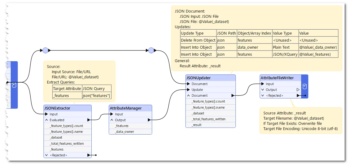

Extract and delete "features" object, insert "data_owner" object, and insert again the extracted "features" object.
It's a kind of hack then... Usually the order of objects in a JSON document is not important, so I don't recommend you to adopt the hack if there is no specific reason for arranging the order.

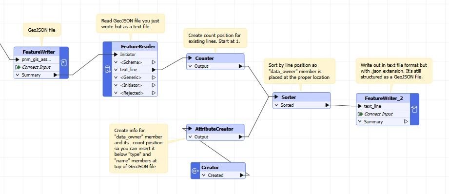

I want to maintain the structure of the GeoJSON (provided by a contractor) so I created my own hack. It’s a kludge but it works. See screenshot.
