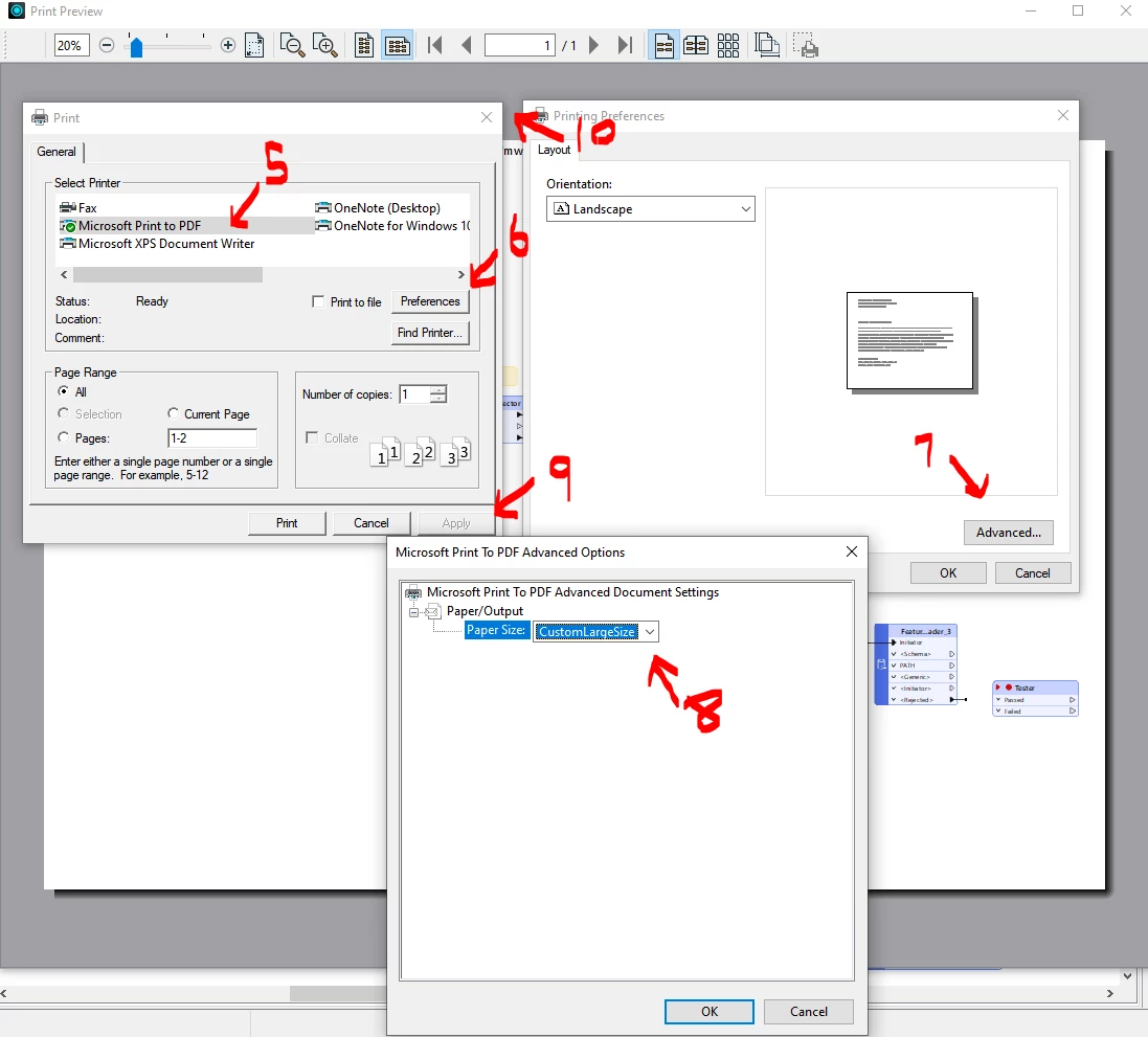

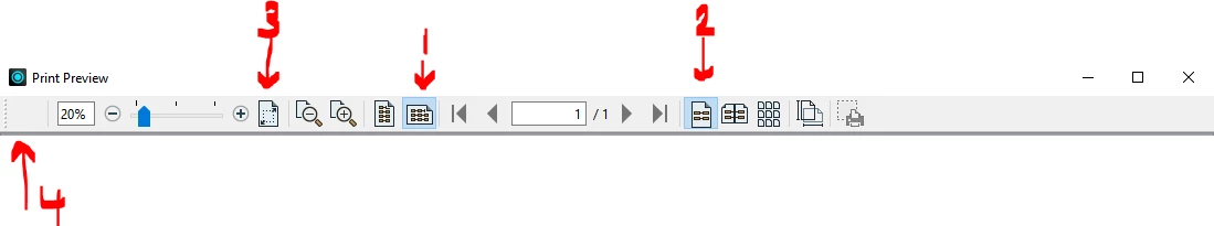

Then, printing the item requires another bit of jankyness to make this work:
  1. click landscape
  2. make sure there is only 1 page
  3. press fit to scree
  4. now it looks “ok” to print, but it isnt yet. hit the print button (mine is missing for some reason)
  1. select print to pdf
  2. hit preferences
  3. hit advanced
  4. choose your newly defined page size
  5. hit apply
  6. DO NOT PRINT YET. exit the window.
Finally, hit the fit to page once again (step 3)
Now, hit print again, and print your item to pdf.
You now have a READABLE (wow) PDF of your workbench! Yes it is huge, but it works!
