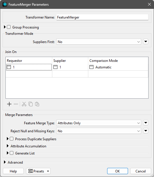

Hey Thimotee,
You can simply use an Excel Reader to read your configuration file, filter out the value you need, and then use a FeatureMerger to attach that value to all the features going into the Bufferer.
For ease, configure the FeatureMerger like this:
  • Treat your Excel row as the Supplier
  • Treat your dataset as the Requestor
  • Use a constant key (like “1=1”) to join everything
That way, you add the buffer distance from your config to every feature.
Note 1: You do need to give each feature the buffer value as an attribute. That’s just how the Bufferer works.
Note 2: I’d stay away from VariableSetter/VariableRetriever. It’s kind of like spaghetti code—harder to debug and doesn’t play nice with caching.

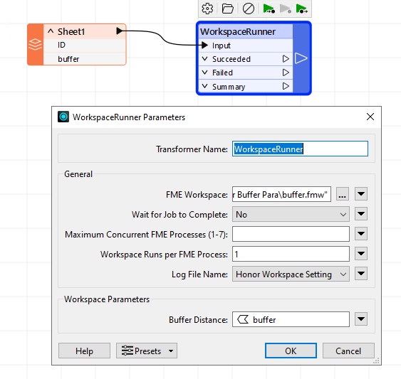

If you don’t wan’t the buffer value on your features, you could a use a workbench runner
Parent workbench would read the excel file, apply any filter and then the workbench runner would trigger the child workbench and pass the buffer distance to a published parameter for the buffer distance in the child workbench.
timotheebecker
Forum|alt.badge.img+3
Thanks,
That sounds like a nice solution too.
