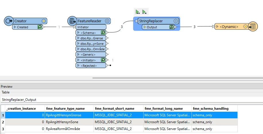

I try to create tables where schema definition is from SQL Server into PostGIS. Schema only
For this i have a simple workflow.
But for the life of me i do not understand why my tables are not created despite FME report everything went well?
String replacer is just changing the name of fme_freature_type_name to remove the standard “dbo.” table qualifyier from SQL Server.
Writer setup
Log

As far as i can tell I should expect to see 3 tables in my database now?
The postgis user has all the privileges to create tables in the schema rplanforslag_alternativ_forslag undoubtedly.

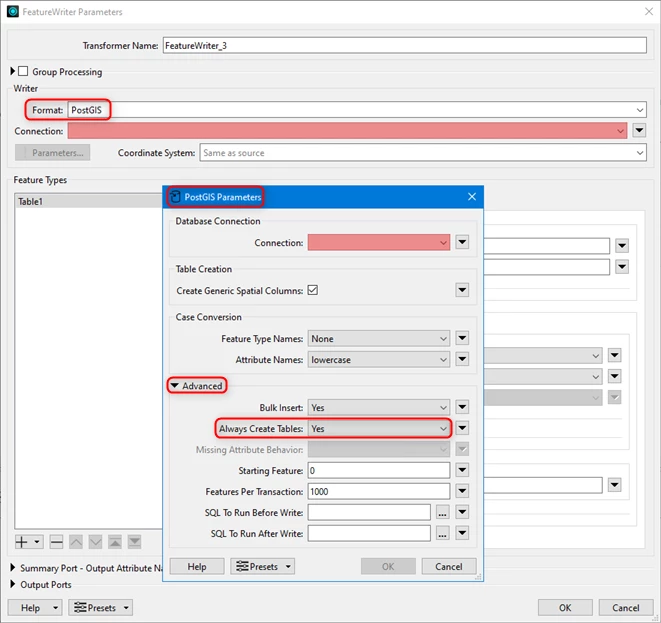

It used to be, no data, no output. So no result would match my expectation. But I think I have read something about being able to write schema only for this exact case and it probably is a newer version then what your are running, based on your screenshot.
Found it:
So pre 2025, no database table creation without data.
But the workaround is easy, just add one dummy record to force it to create the table and delete it after the table creation. FeatureWriter create and insert, FeatureReader read from created, FeatureWriter delete read feature.
Found it:
Found it:
Oh that is great news that it is finally part of the core feature of FME. Thanks for pointing this out. Running to upgrade immediately!
About time really. 80% of the times i need to write empty tables, weird to me it has not been implemented before.
