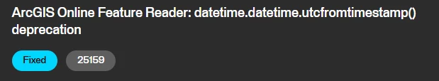

The FME 2025 Change Log shows this entry:
It only mentions the Reader. Would it be possible to know if that deprecation was solved for the Writer, too?

Hi ​@oscard, apologies for the late response here! I looked into the ticket affiliated with that change log entry and it does indeed confirm that the deprecation is fixed in BOTH the reader and writer in FME 2025.0 b25159 and newer. You can download the newer versions on our Downloads page.
