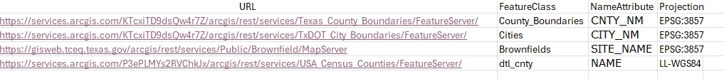

I have a csv spreadsheet of arcgis server feaureservice urls with the featureclass, name attribute , and projection attribute. This list is long and has multiple servers and I want to pass this list into my workspace and have the FeatureReader transformer read the url and featureservice with a spatial filter for my area of interest (AOI) and then clip out the data I need inside the AOI and only keep the attribute name field in the result, run some additional analysis, then write out the clipped results to a GDB, then move to the next record url in the spreadsheet.. My plan is to reproject the AOI to each projection listed in the csv and then pass the AOI as the creator to the FeatureReader transformer to only read based on the spatial filter. This works great if I do separate feature readers for each URL but that makes for a gigantic workspace and isn’t very dynamic as the spreadsheet and AOI changes frequently. Is there a way to pass a csv list to the FeatureReader in this way and accomplish this with multiple dataset schemas?
