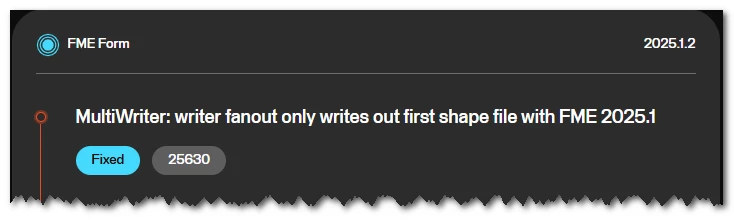

​@DanAtSafe , FME 2025.1.2 Build 25630 - the latest release version is now available, and I found this description in the Change Log.
I thought that the problem discussed in this thread was fixed in the new release, but in my quick test, it doesn't seem to be fixed yet unfortunately.
See the attachment including a sample dataset and two workspaces created with FME 2025.1.2, which reproduce the problem about dataset fanout configuration on Shapefile writer and GeoPackage writer. I'm afraid that other writers could have the same issue.
Hope the issue will be fixed asap.
