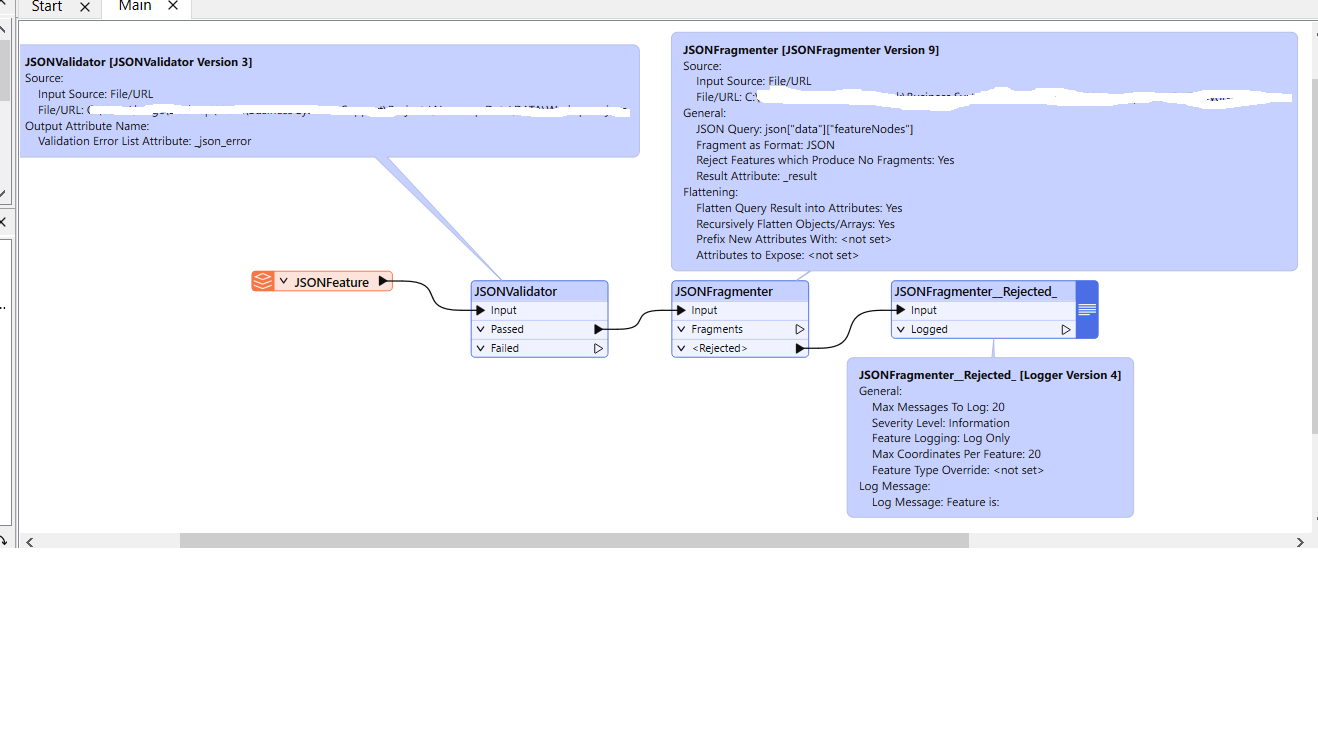

Hi Guys,
I have recently using FME and would like to know if anyone can help me explain how to extract the polygons from a JSON file. I intend to create a workspace, but it does not extract what I need. Also, I have read a few similar questions about this topic but still do not have a solution.
The file is the following one:
Also, I have attached my workspace with much of the work :(
If there is anyone who can help me much appreciate it.
Best answer by nielsgerrits
What you have is GeoJSON. Steps to parse this:
  • JSONFragmenter to split the featureNodes.
    • json["data"]["featureNodes"][*]
  • JSONExtractor to get the geometry from the featureNodes.
    • json["geometry"]
  • GeometryReplacer to replace the geometry attribute with a geometry
    • GeoJSON
  • CoordinateSystemSetter to assign coordinatesystem.
    • EPSG:4326
The trick to find the correct query in the JSON transformers is to first point to a file with the json, generate the query by selecting what you need and then change the file to the attribute.
Attached sample workspace.
    • json["geometry"]
    • GeoJSON
    • EPSG:4326
luisegutierrezc
Forum|alt.badge.img+3
Thank so much @nielsgerrits for your help and explain the process. it was what I was looking for.
