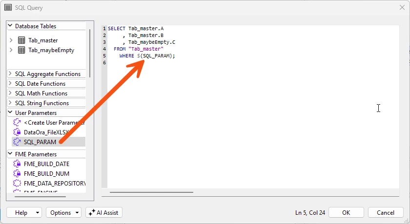

Hi ​@lifalin2016 Would you be willing to share a screenshot of your SQL Query Editor?
I believe if the value is available on the the side bar, it should work. Like how I did here with a User Parameter.
