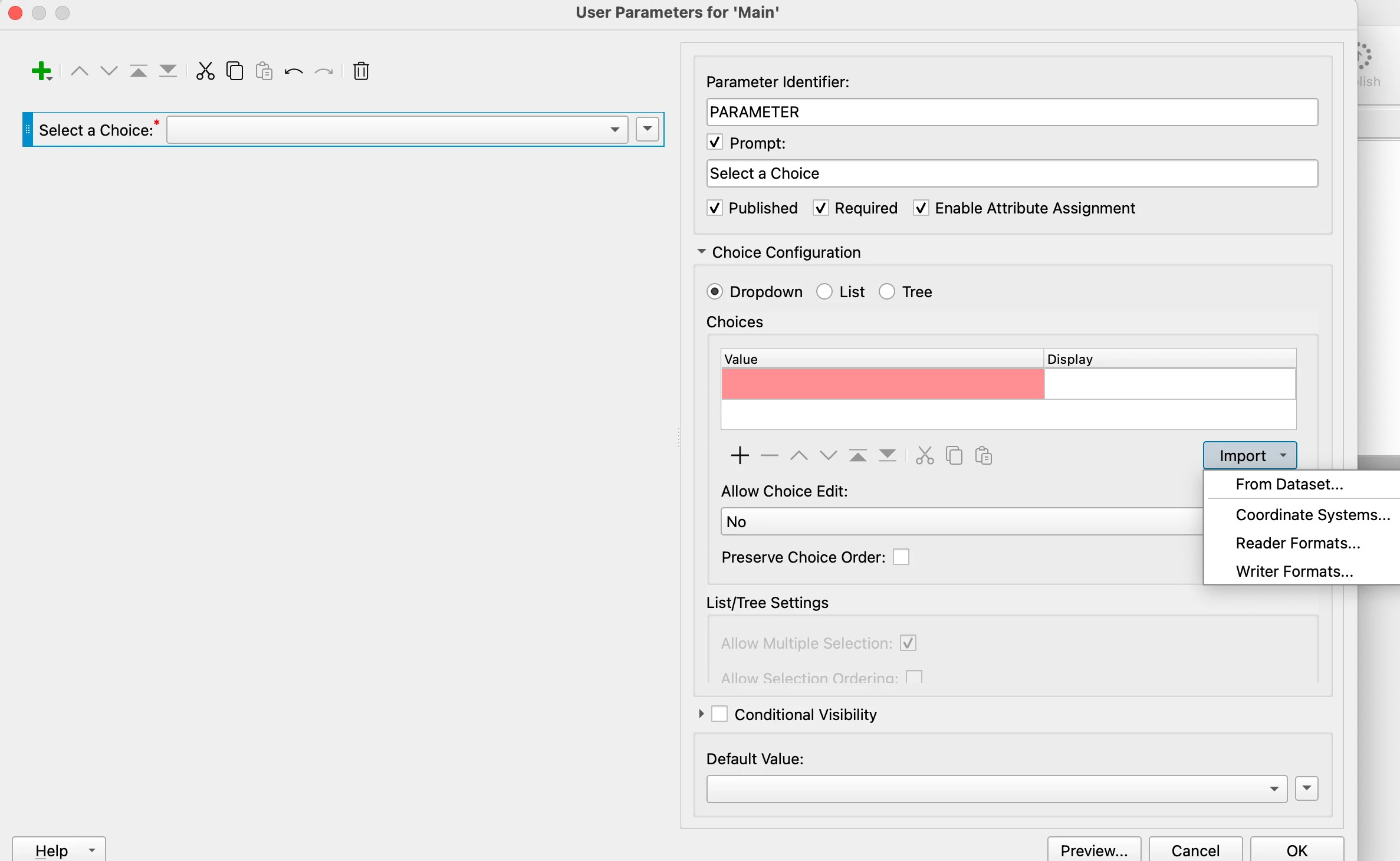

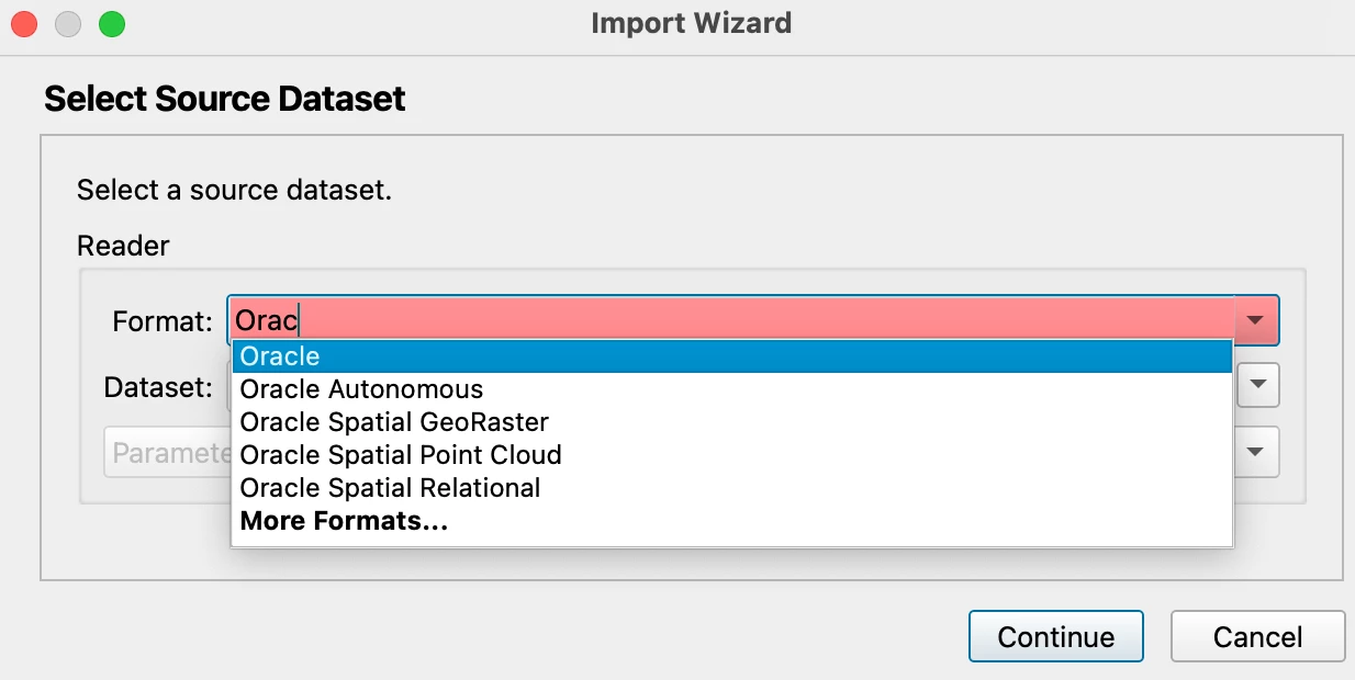

When creating a choice User parameter type, the only option is a static “Import from dataset” to populate the choices. This needs you to update FME workspace, returning to the user parameter if the database lookup change / get new values and import it again (over the top).

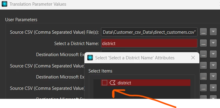

The only other way I can think of is….to do this is with User parameter attribute name, do not disable attribute assignment
https://docs.safe.com/fme/html/FME-Form-Documentation/FME-Transformers/!Transformer_Parameters/adding_a_parameter.htm

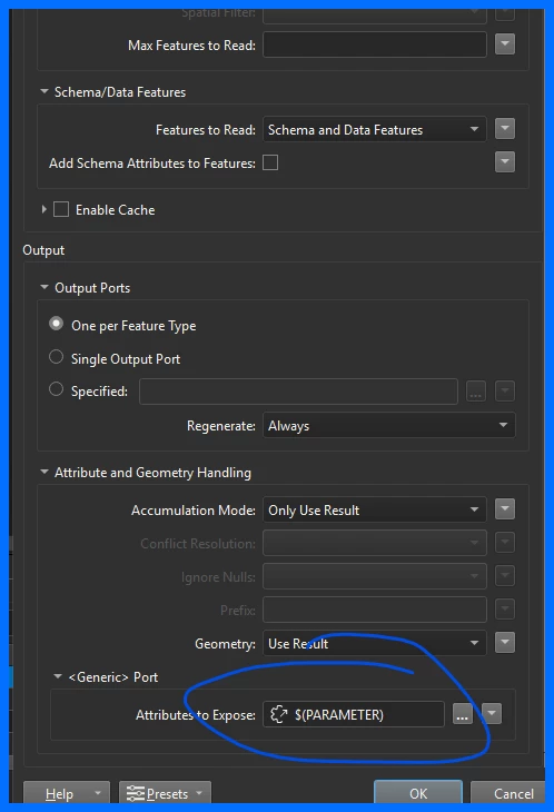

You need this User Parameter assigned to a reader that is connected to the Database and table. See description below. There’s a fair bit of complexity in this option

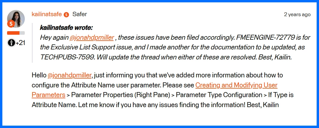

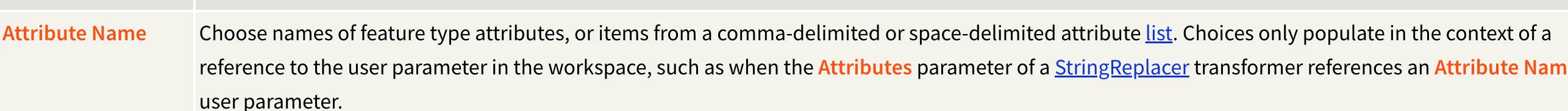

I did a bit of digging and found some more information:
But I still cannot wrap my head around how this should work. Can you expand? In just “trying things out” I did get a result by assigning the Parameter to the Generic Port but I am missing the bigger picture here on this functionality. Any ideas you could share would be awesome and thanks!
