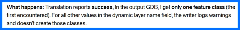

What happens: Translation reports success, In the output GDB, I get only one feature class (the first encountered). For all other values in the dynamic layer name field, the writer logs warnings and doesn’t create those classes.
