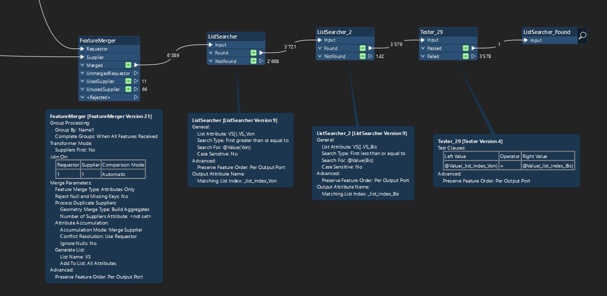

I need to find ‘matching’ rows, where from(1) <= from(2) AND to(1) >= to(2) [colored lines].
What I already tried:
I already attached the second list as an list attribute to every single line to the first list (FeatureMerger) and than tried to find the matching line with two ListSearchers. This is limited as the ListSearcher only finds “First ...”.
Can somebody help?

Could you post a workspace with some sample data? Might make it easier to give some suggestions. Would be helpful to see the data structure as it sounds like it might be better to explode the lists into features and process with the needed logic, then re-make the lists if needed.

I would use an InlineQuerier for this after exploding the lists
Select t1.*,t2.csv_line_number as matched_t2_line
from
"Table1" t1,
"Table2" t2
where
t1."from"<=t2."from" and
t1."to" >=t2."to"
This will give you the matched row from the first table, and the line number of the matching row from the second table.
If I didn’t want to explode the lists, I’d always resort to working with python as FME is fairly limited with working with lists
