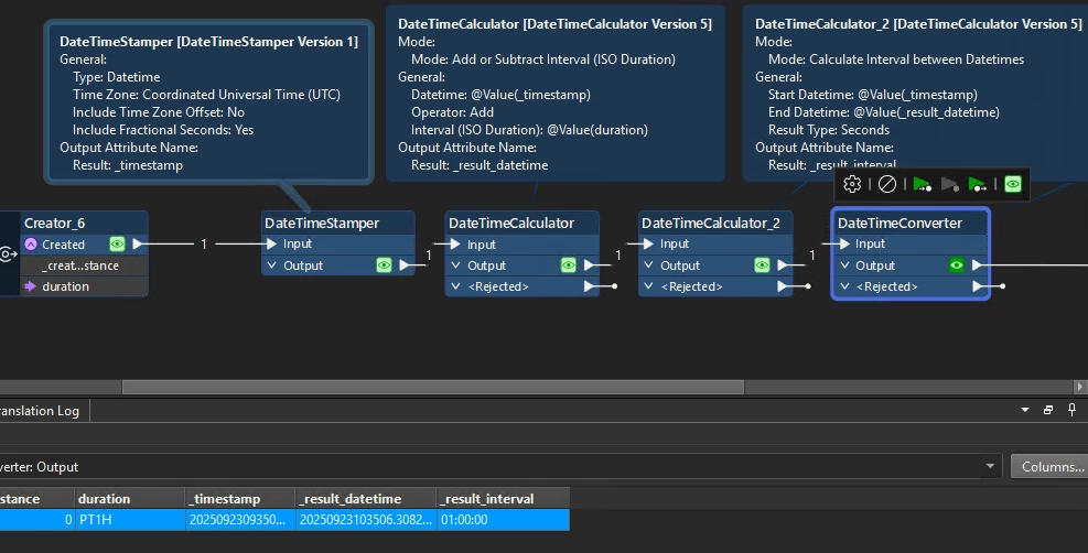

Best answer by ebygomm
An FME way for durations less than 24 hours
Over 24 hours you would need to do the maths to go from seconds to hours minutes seconds and skip the DateTimeConverter since this won’t cope with anything over 24 hours

  • Sep 23, 2025 9:42 AM UTC

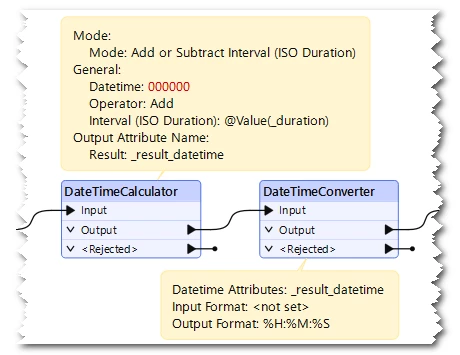

takashi
  • Sep 23, 2025 11:42 PM UTC
For your reference, since the FME Date/Time Functions generally support not only datetime and date values but also time values, this workflow should work as well. Assuming that the attribute "_duration" stores a duration value in ISO8601 format e.g. PT1H and the value is less than 24 hours.
And, it's equivalent to this expression.
@DateTimeFormat(@DateTimeAdd(000000,@Value(_duration)),iso)
