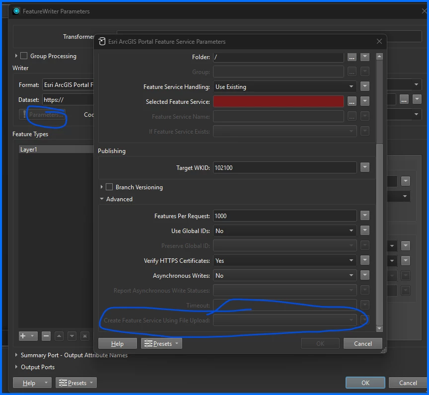

Hi ​@arepsherbentear I don’t know if the Esri interface is the same but when I run into that type of error I find that create feature service using file geodatabase option.
Do you have that as an option?
arepsherbentear
Forum|alt.badge.img+9
Just as in your screenshot, the setting is not available so it is off.  I don’t want that turned on.
