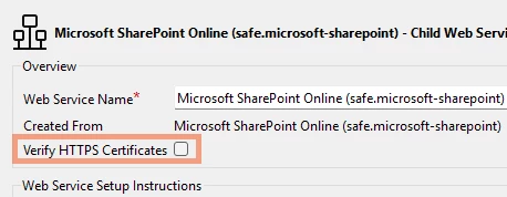

Alternatively, other users have found it helpful to uncheck "Verify HTTPS Certificates" in the web service definition in FME Form before uploading it to FME Flow - worth trying as a quick test.
That said, the long-term fix is getting your Enterprise CA certificate into the right store on the FME Flow server side.
