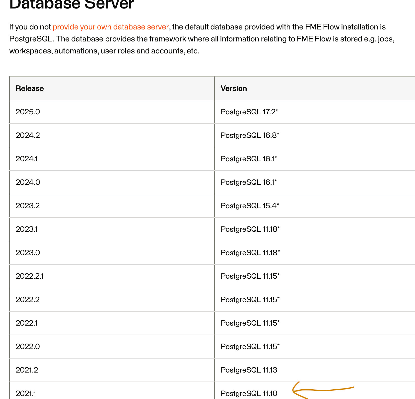

I am installing FME Flow 2021.2, and I wanted to check on the version of PostgreSQL I should be using, and the instructions on how to configure a provided a database server. As per Safe’s documentation, it seems I am looking at 11.13 but this version is long retired. I did find the following post that seems to indicate it is still compatible with 14:

The following article talks to the Postgresql and FME Flow compatibility https://support.safe.com/hc/en-us/articles/25407796731917-Third-Party-Component-Versions-for-FME-Flow  You can only use 11.1 Postgresql with FME2021
