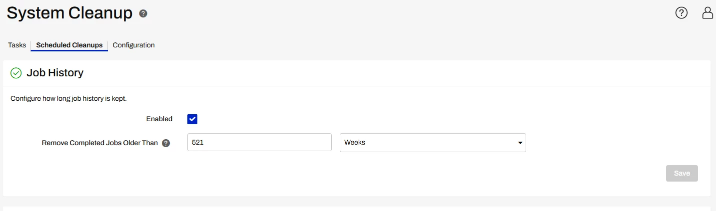

I want to ensure that the Job logs are retained for 521 weeks and do not get deleted during the system cleanup.
As a result, I have configured as per the screenshot in the above image.
Is the configuration accurate?

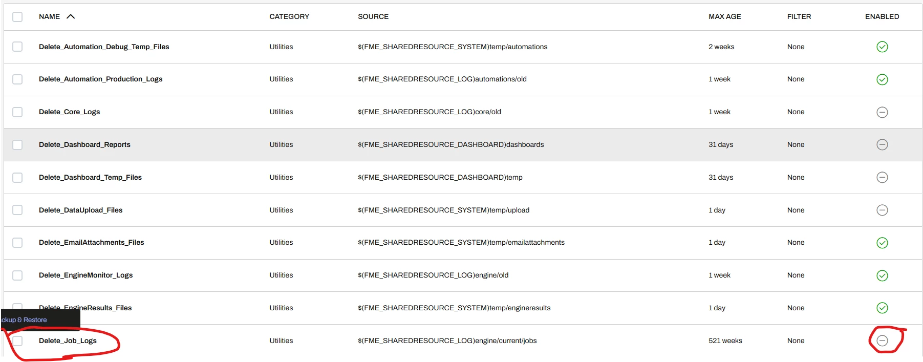

Right now you have the job logs deletion disabled, so they won’t be deleted at all. If it does get enabled somewhere down the line it’ll only delete logs that are more than 521 weeks (i.e. 10-ish years) old, so I think you’re good.
However, 2 things I’d like to point out:
  • How many jobs per year are you expecting to run? Be careful you don’t run out of drive space (because that will trigger more strict cleanup tasks and it may be that job logs are still deleted if that happens)
  • How likely do you think it’s going to be that you’ll need to see a job log from such a long time ago?
Unfortunately there’s only one setting for the job log deletion and I wish there would be some more fine-grained control. Like on jobs that are run monthly, I’d like to retain them for a bit longer so if one run fails I can check it against the previous log, from a month ago.
