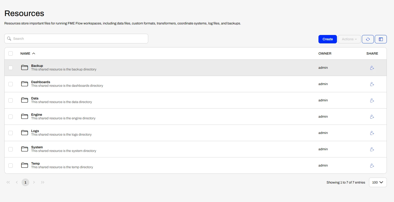

I would like to add the following folder, named "moi”, to my top level resource folders, and add it to the list in the picture below. I couldnt find that much information about it online, and i tried something, but it didnt work.
I located the folder in the FME Flow program files, and added the folder, but that didnt work. It doesnt show up in the top level resources list,
Does anyone know if it is possible to do this? And how?

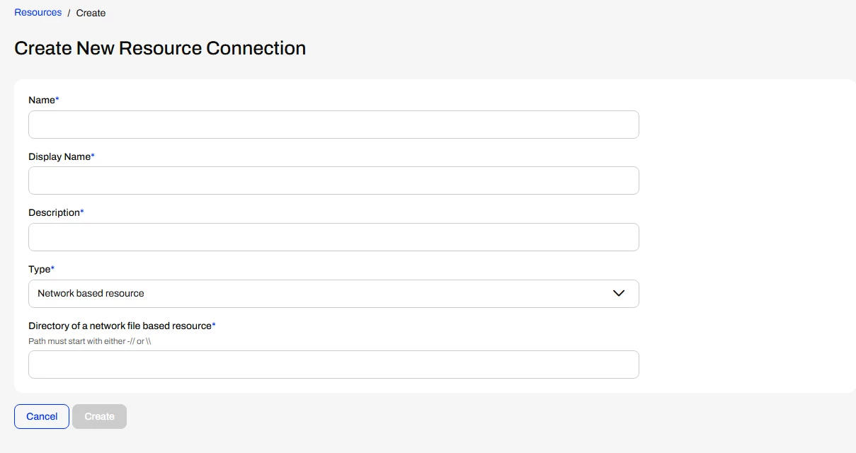

Do you not just click Create and Create New Resource Connection?

FME Flow Resources is not a single physical folder. It’s more like an interface that gives you access to different storage locations. You can think of it as mounting a folder on Linux or mapping a network drive on Windows.
What you see at the top level (Data, Temp, Backup, …) are not just subfolders, but resource connections that have been defined in FME Flow. Each of them points to a specific location on disk (or even remote storage), and within those you can create or remove files and subfolders.
So if you want to add a new “folder” to the top level of Resources, what you really need is to create a new resource connection in the FME Flow System Configuration. Simply adding a folder under the program files won’t make it show up in the Resources interface.
