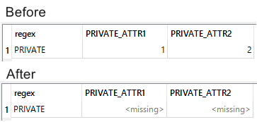

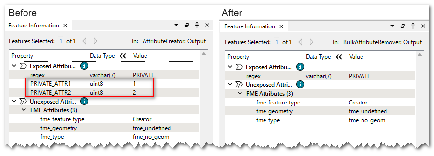

Hi ​@lilywong ,
I think BulkAttributeRemover definitely works as expected, even if the regex is given by an attribute value.
BulkAttributeRemover Input and Output
In the Table View of FME, <missing> means that the attribute does not exist, the attribute name is just being shown in FME Workbench interface. Since FME Workbench cannot know the attribute value (regex) when you edit the workspace, the target attribute names won't disappear.
I would recommend you to determine if an attribute exits, see the Feature Infromation window rather than the Canvas interface or the Table View.

Hi @takashi,
thank you very much for your suggestions. I followed your advice and took a closer look at the Feature Information window to better understand which attributes remain after using the BulkAttributeRemover and which do not. Indeed, in both cases—whether I pass the regex manually as a string or as an attribute value—the attributes I intended to remove do not appear in the Feature Information window.
However, it seems that the BulkAttributeRemover (BAR) still handles the two methods of passing the regex differently.
When writing the BulkAttributeRemover’s output to a FeatureClass in an Esri Geodatabase (the same format as the Reader), the attributes to be removed are not written to the output table if the regex is entered manually. Additionally, they do not appear in the Canvas interface or the Table View.
On the other hand, if the regex is passed dynamically as an attribute value, the attributes not only show up in the Canvas interface and Table View, but the values of the attributes to remove are successfully deleted as expected.
Interestingly, the attributes to remove are still written to the FeatureClass table, even if they don't appear in the Feature Information window after the BulkAttributeRemover process. In this case, the BAR seems to not fully fulfill its intended purpose, correct? It seems to me, that it is doing only half the job in this case.

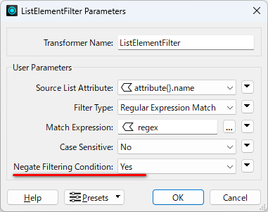

  • May 22, 2025
Hi ​@woelfl ,
If you are attempting to configure the destination schema with schema feature read by FeatureReader, consider using ListElementFilter from FME Hub to modify the schema definition (i.e. "attribute{}" list) with the same regex used in the BulkAttributeRemover.
ListElementFilter Parameters Setting Example
