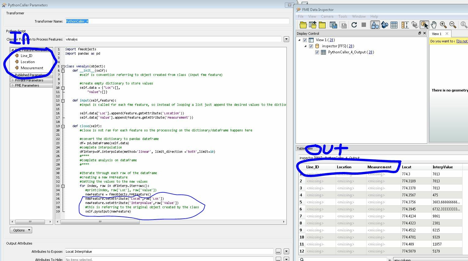

@david_r thank you for the response. I realized a picture did not post that would help clarify. The input has 3 attributes visible in the image below. As I am calling fmeobjects.FMEFeature() and assigning 2 attributes to the newFeature to be output I was expecting the output to have only two attributes. However, it has 5, the 3 original, and the 2 new ones. I assumed I was misusing some aspect of fmeObjects and that is what I was looking for clarity on.

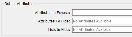

Could you perhaps mean that the attributes visible in FME Workbench does not reflect the Python script? If so, you need to manually configure which attributes are visible ("exposed") after the PythonCaller, using the bottom section of the PythonCaller settings:
This is necessary because FME Workbench cannot, by itself, interpret the Python script to decide which attribute is introduced or removed during the script execution.

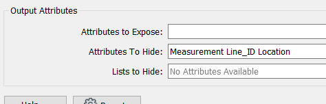

As I mentioned in the second post, FME doesn't know what's going on in your Python script, so you'll have to explicitely tell it that these three attributes not longer exist on the output schema (as you can see on your screen dump, the attribute values are not present on the output features).
Try adding these three attributes to "Attributes to hide" in the PythonCaller:
Thank You, After your second post I saw the "attributes to hide" setting. So I guess FME just automatically assigns the input attributes to the output feature, -even if it is a completely new feature- unless explicitly told not to. I was concerned I was misusing fmeObjects and could cause in issue of collision between input and output features.
