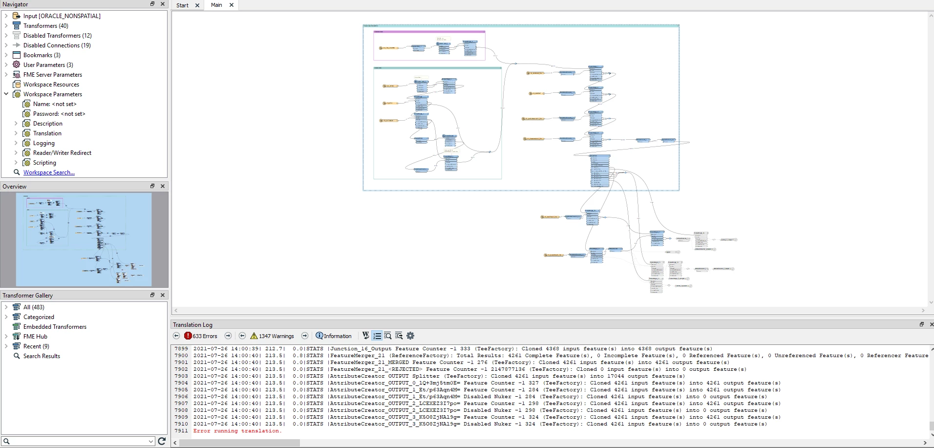

Hi all,
well, we did some adaption to virtual memory and cleaned the attributes, but the workspace still fails :-(
Now I even have a more simple workspace, which fails. The reader is still Oracle. I cannot provide the workspace and data (security issues). I added the log-file including debug-information. Hope this helps
and a screenshot of the workspace

@gpt_geoinfo​
Could you share how long this takes and how many records is expected to be read (just to get the size of the data process)?
Something you can try is to add some Recorders to the Oracle Readers and record the data locally. (All other transformers disabled, feature caching turned off).
If this completes... you have the data locally now.
Next, disable the Oracle Readers, add Player Transformer to your workspace (to read back the output of the FFS files). Run the workspace... does it fail again? It might help you isolate a transformer that is causing the process to fail.
Check your disk space before and after. It sounds like you are pushing the system to the limit. More Ram? More Diskspace? FME_TEMP is a good option but again... maybe the drive is being filled up so watch the drive space closely.
Are there any other competing applications on the server that could be taking memory or resources away from FME?
Good luck!
