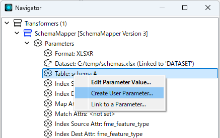

Hi ​@rickarhayd ,
You can create a user parameter linked to Dataset and/or Table parameter in the SchemaMapper on the Navigator window. Right click the parameter > Create User Parameter.
You can then pass preferable Excel file path and/or sheet name to the parameters through WorkspaceRunner.
Create User Parameter linked to SchemaMapper Parameter

Hi ​@rickarhayd ,
