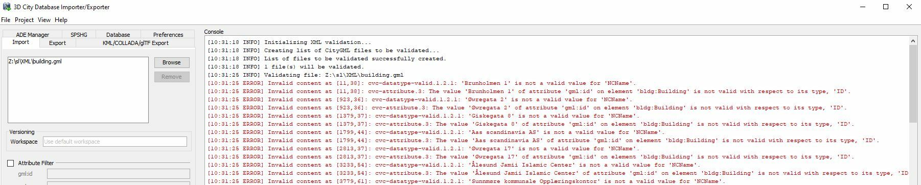

But when I imported it into the 3DCity Database, I got some error notifications after I validated this file (please see error1.jpg).
This is error information:
[07:49:38 ERROR] Invalid content at [1887106,22]: cvc-complex-type.2.4.a: Invalid content was found starting with element '{"http://www.opengis.net/citygml/relief/2.0":reliefComponent}'. One of '{"http://www.opengis.net/gml":metaDataProperty, "http://www.opengis.net/gml":description, "http://www.opengis.net/gml":name, "http://www.opengis.net/gml":boundedBy, "http://www.opengis.net/gml":location, "http://www.opengis.net/citygml/2.0":creationDate, "http://www.opengis.net/citygml/2.0":terminationDate, "http://www.opengis.net/citygml/2.0":externalReference, "http://www.opengis.net/citygml/2.0":generalizesTo, "http://www.opengis.net/citygml/2.0":relativeToTerrain, "http://www.opengis.net/citygml/2.0":relativeToWater, "http://www.opengis.net/citygml/2.0":_GenericApplicationPropertyOfCityObject, "http://www.opengis.net/citygml/relief/2.0":lod}' is expected.
In some cases, I could validate the CityGML file successfully, but I got another error when I imported it into the Database using 3DCityDB (please see error2.jpg). I knew that the address in XLink did not exist in the CityGML file, how could I do to solve this problem?
What did I miss?

Those error you are seeing in the importer-exporter tool are because your gml:Id's contain spaces. A valid gml:Id must start with a letter and contain no spaces and also be unique. Otherwise it sounds like ​you're on the right track.
Also to note, the importer-exporter will probably be able to import these data ok without issue, however, other ​applications might have issues.
Good luck!​

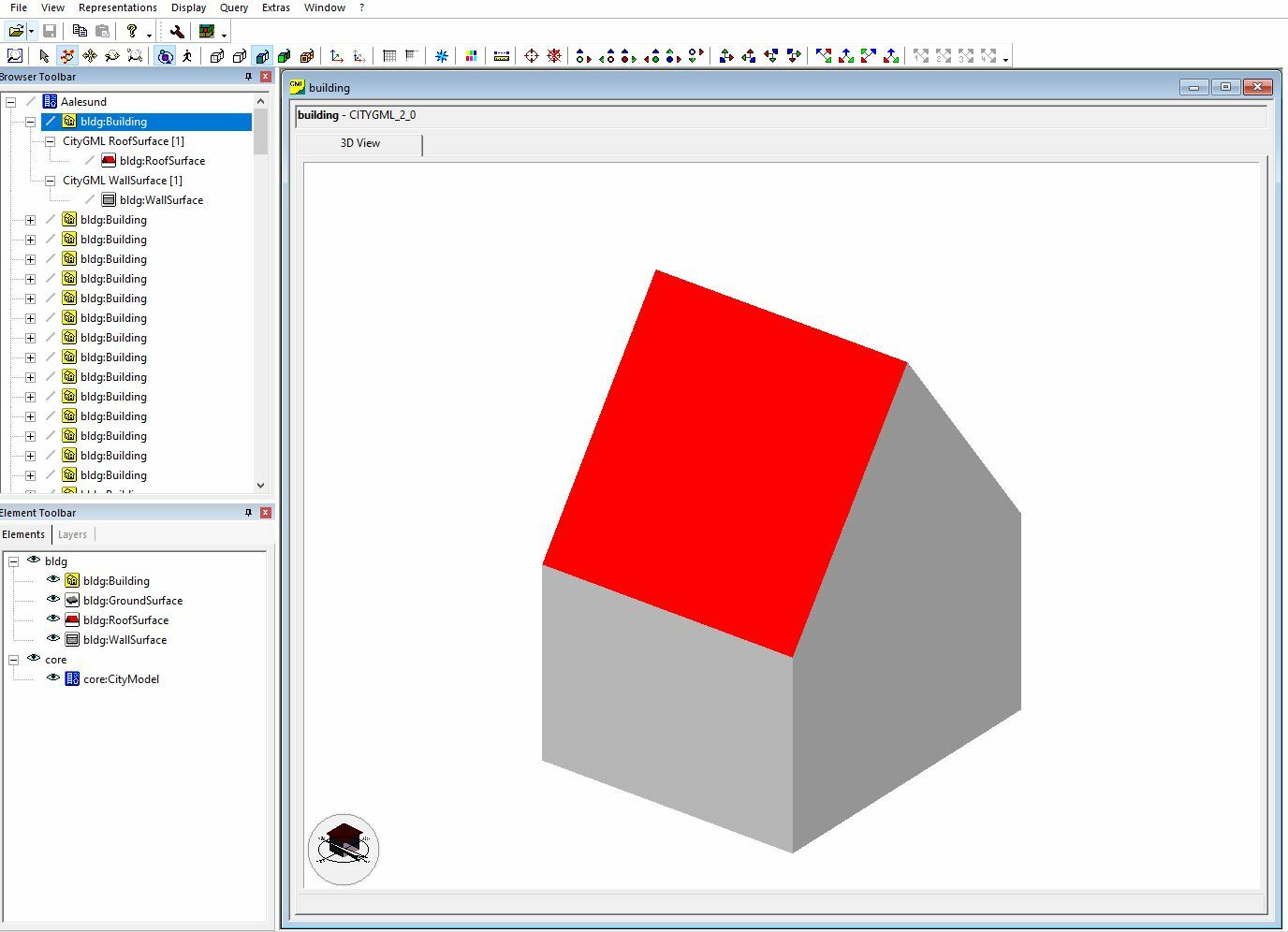

I suspect that these errors are related somehow to the textures or appearance. I'm not quite sure whats going on but it looks like you have some extra appearance references. I think it's fairly safe to ignore them though. It's hard to say where the problem is coming from. Were there any warnings in your fme log file?
Have you tired exporting a building to see how it looks?
I have a minor suggestion, if you can I would try and write the building data out as lod2solids instead of lod2MultiSurface that is a little better when it comes to best practice but it's not invalid what you have, just not as common.
I would also try and create xlinks from the solid surfaces to use the wall, ground and roof surfaces - this is an example showing how it can be done it FME https://hub.safe.com/publishers/con-terra/templates/citygml-create-building-lod-2-using-xlinks
If will safe space and is best practice

There was no error notification or any warnings in my fme log file. It reported that exporting was successful.
I tried to ignore these errors and importing into database was correct. But when I exported to kmz file to view on Google Earth Pro, the textures had gone.
Buildings in my CityGML file did not have footprint (ground surface), so I think that writing the buildings as lod2solids maybe getting unsuccessful.

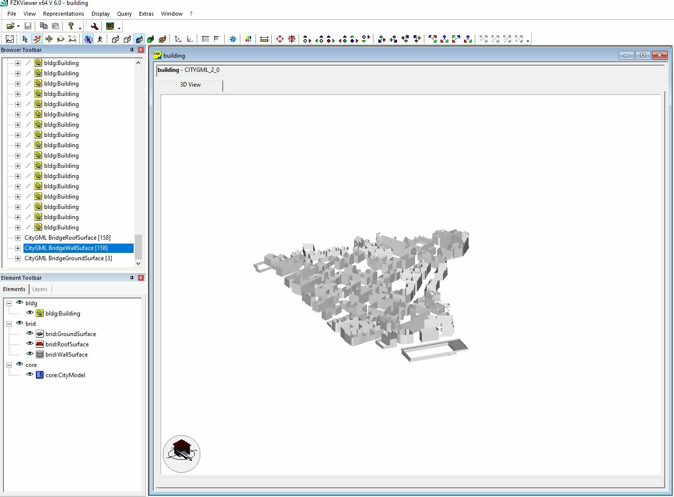

Yes. I tried to open my exported CityGML in FME, it was pretty good when texture had been imported successfully. Please see the attachment.
