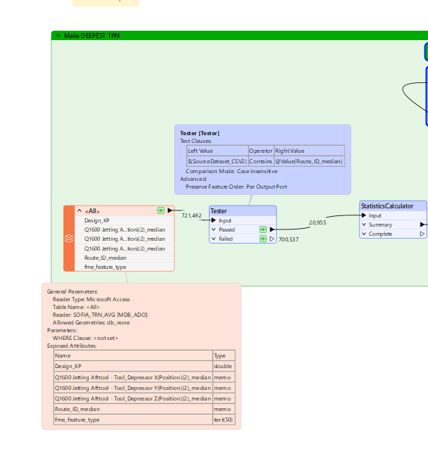

The example below works fine by using a Microsoft Access reader which compiles all tables into one single merged feature type. After that I compare the source CSV file name against one of the listed attributes and pass forward only the matched lines.
That method worked well and served its purpose, but the downside is that it is way too slow since it is reading the whole accdb and this file is constantly growing because we keep on adding tables over time.
I have tried to use the Feature Reader with an initiator which provides the route ID as a key to search an open table if name contains the ID but with no luck. I have tried to add a SQL WHERE statement but still no luck.
Once again, my simple aim is to pull out tables from a accdb which names meet the ID criteria.

I see the file is on a network share. Copy the file to a local folder and see if the problem goes away. If this is the case, the file location is causing the time to load.
takashi
  • April 23, 2025
Hi ​@chavdar .
In my quick test, it seems that the WHERE Clause setting in FeatureReader (Format: Microsoft Access) doesn't work if Feature Types to Read parameter was blank (<All Feature Types> is shown).
Select all the feature types (tables) in the parameter and see what happens.
