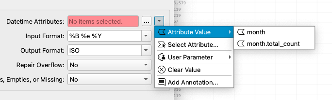

I have an attribute called “month” from an imported CSV. I’ve formatted the value to be in the format “September 1 2024”.
Now I want to convert the “month” attribute to a usable date format such as ISO YYYY-MM-DD.

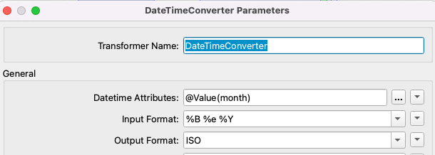

If I use the dropdown to select the attribute, the value of the DateTime Attributes becomes “@Value(month)”.
When run, the workspace sends all rows to the Rejected port with fme_rejection_code. = MISSING_ATTRIBUTE_DATETIME and fme_rejection_message = Null, empty, or missing datetime was found. Enable the passthrough parameter to disable this

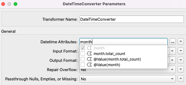

However, if I manually type in “month” into Datetime Attributes:
I get the expected results:

Best answer by veschwab
Hi!
This seems to be a common problem (possibly a bug), you just need to make sure to choose the attribute with the arrow, not the one that starts with @Value :-)

veschwab wrote:
Hi!
Same problem here:
Yep that is the same issue. I didn’t find that post when looking for similar issues to mine.
Thanks!

I can confirm.
The "DateTime Attributes" parameter requires the name of the attribute, not its value.
With it set this way, the DateTimeConverter will look for an attribute named "September 1 2024" and try to use its value. Since your feature doesn't have an attribute with that name, you receive the error: "Null, empty, or missing datetime was found."
The DateTimeConverter shouldn't suggest selecting this value. This issue lies with the user parameter type “Attribute”, and persist in the newest version.
I’ll create an issue for safers to look at that.
