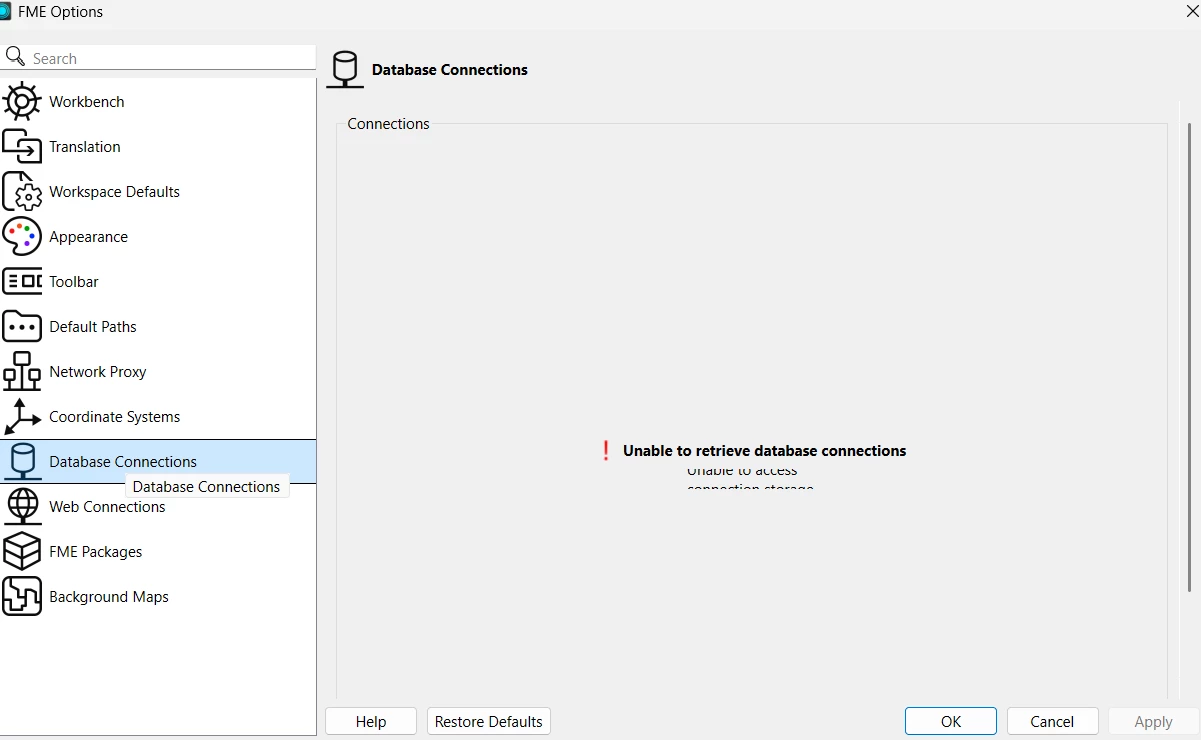

​@j.botterill Thanks for the reply, however the links you provided are mainly about the formats (readers/writers), and not about the Database- and webconnections that are written to the fme_userconnection.data  file. Adding/removing database can be done via Tools → FME Options → see image below

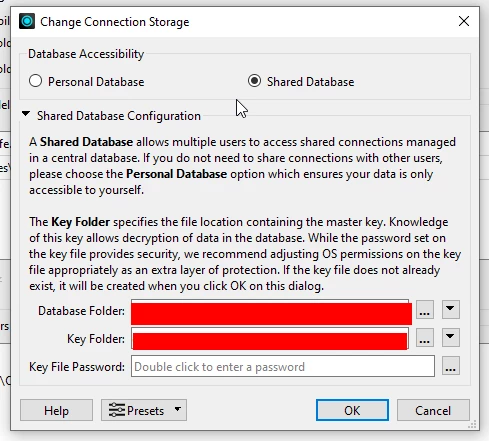

​Hello ​@joy
For FME 2024, we have recommended using a “Shared Database” in virtualized desktop environments due to the changes mentioned in https://support.safe.com/hc/en-us/articles/25407756230669-Changes-to-Connection-Storage-in-FME-Form-2024
A “Shared Database” can be set via Tools > FME Options > Default Paths > Connection Storage.
As the Database Folder and Key Folder paths for a “Shared Database” cannot be set to %appdata%\Safe Software\FME, the paths should be set to another location where files are copied as part of the virtual desktop profile. Each user would have their own personal “Shared Database”.
You need to ensure the master key (.fmekey) is copied to the location set in the Key Folder parameter as part of the virtual desktop profile, as the key allows for decryption of data stored within the connection storage database.
For an added layer of security, it is also recommended to adjust the operating system file permissions to the master key file appropriately. For example, permissions on the key file can be adjusted so it is accessible to the user that owns the key file.
In addition, any connections added or imported must be marked as “Shared” in the web or database connections manager, otherwise these connections will not persist the next time a user logs in to their virtual desktop. If a connection is not marked as 'Shared', it is saved as a personal connection, which are encrypted per-user and per-machine even in a “Shared Database”.

​@fraser.church The workaround we use is to write the connections to a shared database, since the shared database is not encrypted based on machinename.
In the database folder and key folder we refer to a onedrive map, therefore it's still kind of personal. So we kinda misuse the shared database option.
In database connections if you make a new connection, you should not forget to put this on shared, since the default is personal
Hopefully your organization uses onedrive, so that you can try out this workaround.
