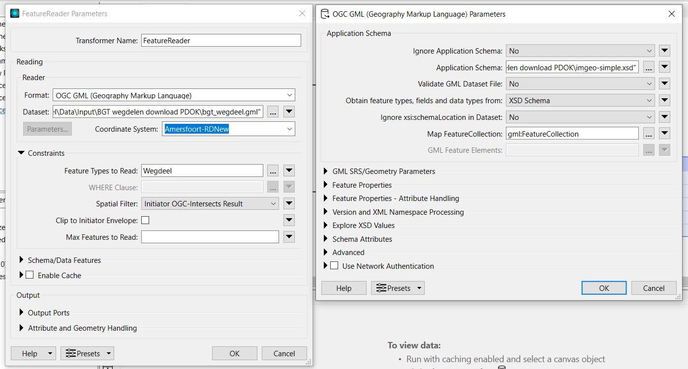

Normally I use FeatureReader to import my datasets. This time I am dealing with a 4.5 GB GML dataset.
What are the best settings to improve reading speed for my FeatureReader? Just like a general approach to use, reading GML file is just an example. I also other formats like .gdb, xml, json etc.
I try to use the SpatialFilter when possible which makes the reading already more targetted. Hence, its switched this time also using my study area as Initiator.

@virtualcitymatt how about these 2 features. Does it make sense to use them, and for which cases?
I’ll be honest I haven’t actually used the Enable Cache option but I can 100% see it being helpful. If you are always working with the same data then this will most likely speed up the process a lot. What I’m very unsure of though is what gets cached. For example if you have a spatial filter of area x and then you have another spatial filter of area y which doesn't overlap what will happen - does the data get cached pre or post filter. This would be a good test.
As for Schema/Data Features I’ve certainly used just data features before to skip outputting a schema features. I feel like it was faster just outputting data features and Schema Features as well but it was a few years ago now that I played around with this setting. In general if you’re not working on a dynamic workflow I think you can skip the schema feature.
