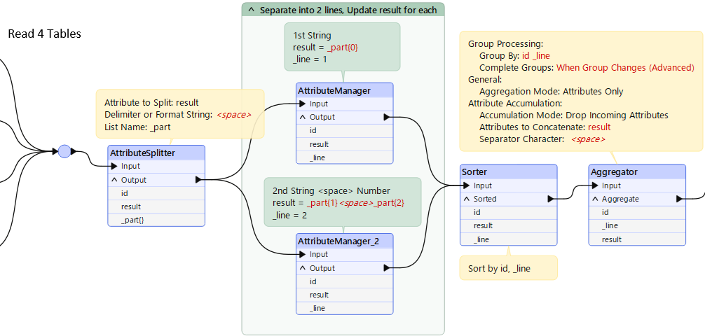

I think the workflow shown in the screenshot could help you. See also the attached workspace example to learn more.

Assuming that these 4 records will be read from 4 tables - one record per table.
table id result
table 1 1 AAA BBB 100
table 2 1 CCC DDD 200
table 3 1 EEE FFF 300
table 4 1 GGG HHH 400
In the case above, do you want to write these two records into a single destination table?
line id result
1 1 AAA CCC EEE GGG
2 1 BBB 100 DDD 200 FFF 300 HHH 400

I need to write the output into result column ,as you wrote
when each table have same id
first line AAA CCC EEE GGG
Second line BBB 100 DDD 200 FFF 300 HHH 400
